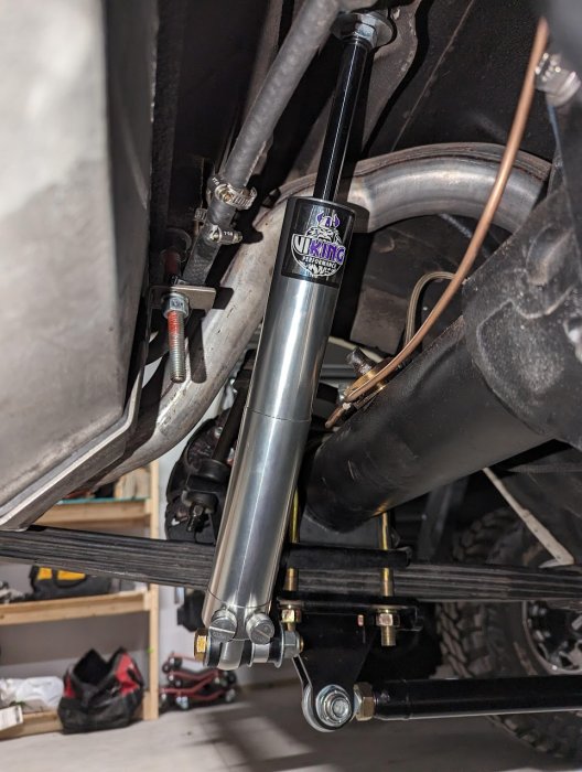

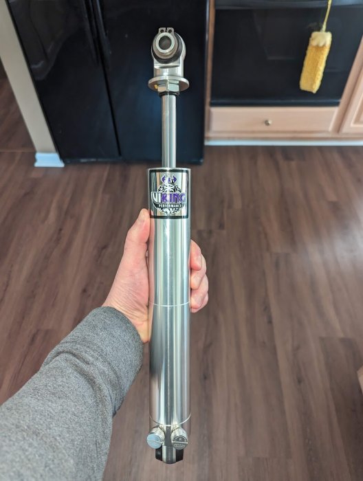

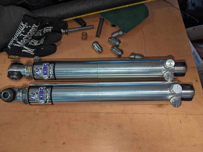

If you want your cake and eat it too then you need to start with double adjustable shocks on all four corners.
