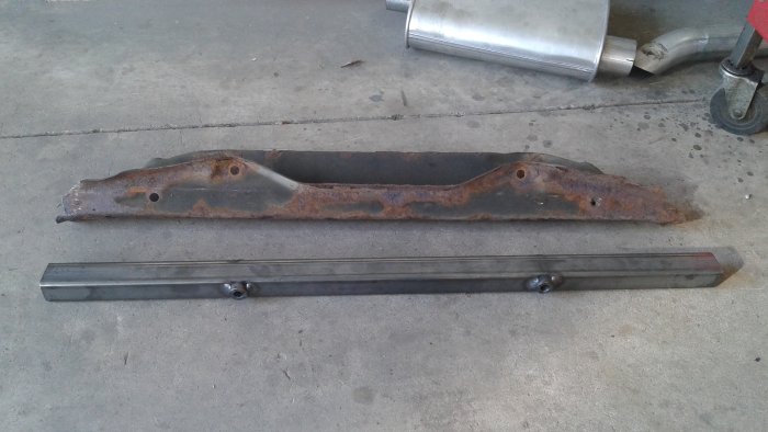

Is the rear shock cross member on other cars only tacked to the frame rails? I can't believe it. The damn thing just flaps in the breeze. At first I though the welds to the floor broke, but it doesn't appear to have been assembled that way.

My Mirada always made a strange boing sound when going over bumps. I couldn't find anything loose so I made a heavier version out of tubing since the crossmember seemed to be the flimsiest part in that area. I'm sure the shocks are more effective now and the sound is gone.
1x1 tubing for the new crossmember?

No, 1 1/2 x 1 1/2. A couple of installation tips: bolt the shocks on to locate the proper position, make sure the bolts can be removed, and check exhaust clearance.
