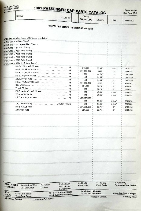

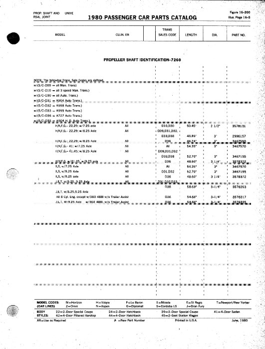

I thought you'd never ask!!! (LOL)
1980 and 1981 Parts Books scans attached

What an absolutely atrocious/abysmal rendering of the uploaded images you guys...yikes...I can't read any of it...PoS forum functionality, seriously...in today's age there is literally ZERO reason to downscale images!!!

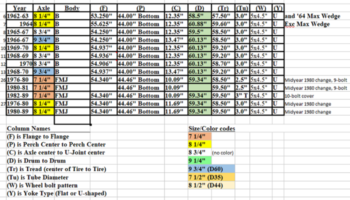

Flange to flange, drum to drum, and perch to perch DID NOT CHANGE in 1980 for FMJs
What allegedly changed was tread to tread, 1" total or 1/2" difference on each side.
In the end this is irrelevant to an axle bolting on, the key measurements are the same for ALL FMJs
No, flange to flange DID change an inch. That's been documented before and I saw that first hand putting a 79 axle in my 88. The only way tread to tread could change and nothing else is if offset or width of the wheels changed. And I think they did go from 6" to 7"? I'm guessing the axle width change had something to do with that or the body change between 79-80 and wider might have also fit the J bodies better?

I think the difference is the charts usually use flange to flange for sizes because it's a fixed measurement.
Flange to flange of early F/M is 54.340. And perch is 44.46
Flange to flange of later is an inch wider.
Early B body 8 3/4 is usally listed at 55" flange to flange and 44" perch. Which is why that's usually what people say is the preferred 8 3/4 axle to use.
The C body axles noted a few posts above is 59.2" flange to flange (NOT tread to tread) and 47.3" perch which is too wide.. C body. Big car. No surprise there.
