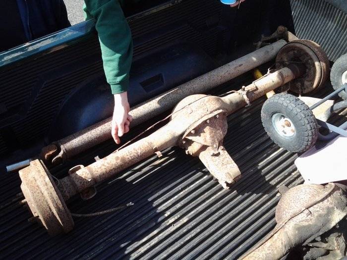

Grabbed a few rears:
1970 B body 8 3/4
1973 B body rear
78/79 8 1/4 F body rears
If anyone is needing to upgrade, we have 400 into each 8 3/4 and 300 8 1/4s

And to add an update, Gator pulled the stuck brake drums and (Drum roll Please) the 70 rear is a SURE GRIP 741 with 2.94 gears. Iwant to keep it and go find an F body to stick it in. My logical responsible side says sell it for 600

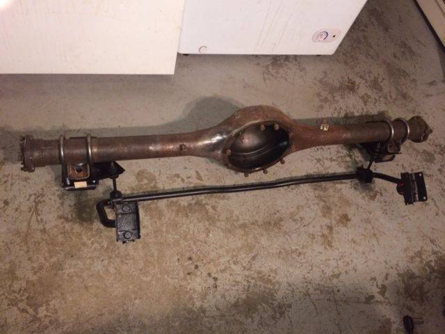

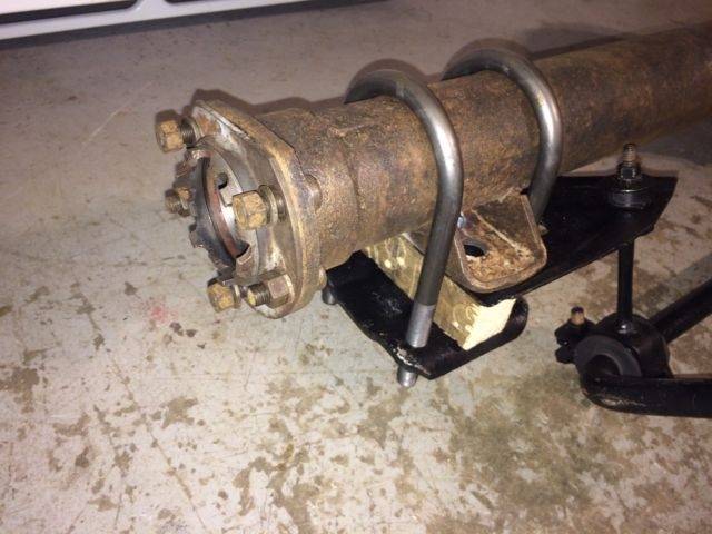

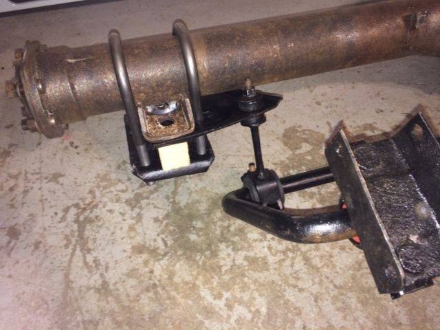

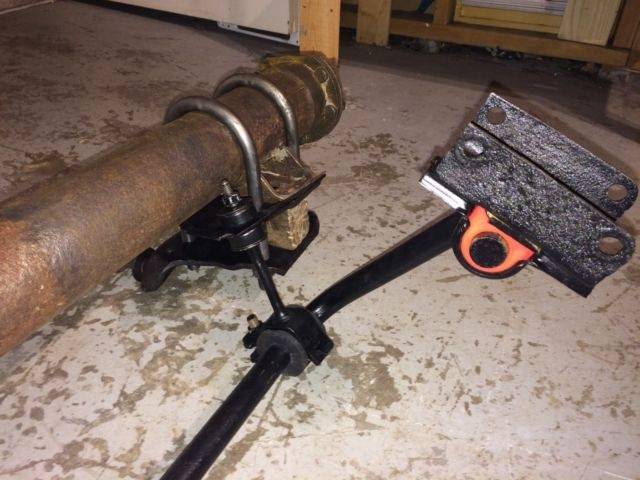

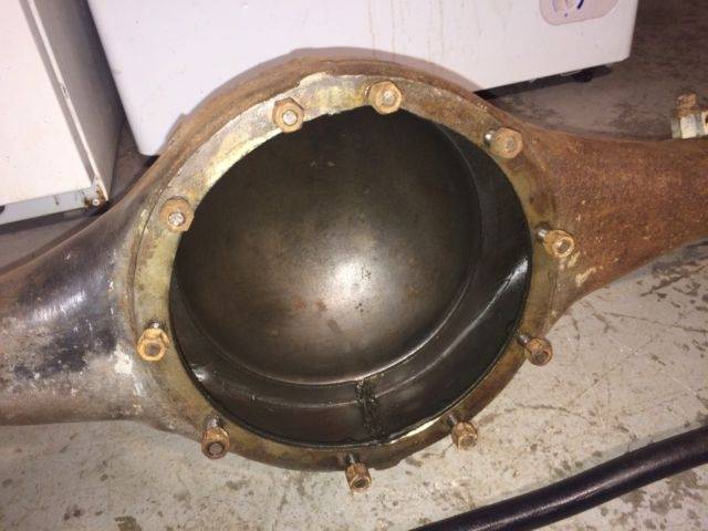

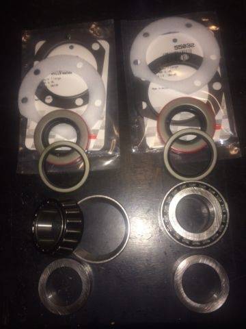

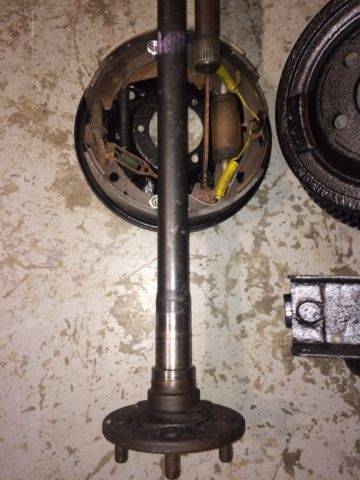

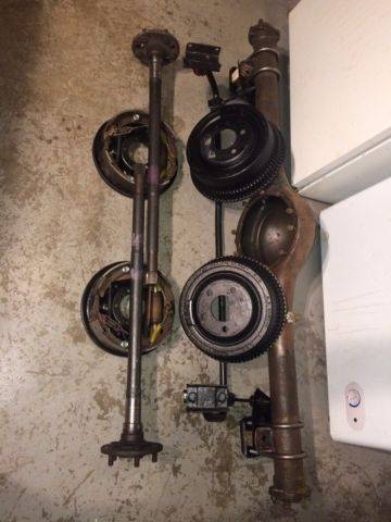

Yes these rears are difficult to find for sure. Canada used the 8.75 in some of the BBodies up to 74. They are perfect for use in 71-79 BBodies. 73 and 74 were set up with the rubber buscut mounting garbage but can easilly be deleted with the earlier spring mounts.
I currently have one for sale but I am in Canada just want to show off this rear as its in amazing shape for a Canadian rust-belt rear lol
It is a 73 8.75 and I've converted it to an ISO delete along with the antiswaybar (I do have a second antisway bar complete for these rears as well. Here are pics of the setup withe extra thick Ubolts.
Almost new brakes and bushings and all new seals and bearings from drDiff.
1,494
Looking nice!
Too bad they are not a FMJ bolt in (at least not without mods).
Kernel Sanders
Mar 10, 2011
95
13
Ottawa, Ontario, Canada
Looking nice!
Thank you and exactly (re drop-in) and I'm not sure how well width-wise the wide rear will fit on an FM or J car. I know the front track is definately not as wide so the rim back spacing would have to paid attention too
This was going to be used to replace the 8.25 in my 74 Charger but I got an offer on the car I couldn't refuse and the purchaser didn't want to pay the extra for this rear nor the loaded big block ISO delete Kmember with 11.75" brakes with all new bushings and joints and steering components.
