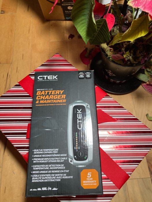

Kostas --
Was under my tree this year ....
JW
That is the perfect one. Some have only 4 LEDs, and don't tell you much about the status of the battery charging. This one has the full 7/8 LEDs, and will light up in sequence to really show where things stand. This one also has the recondition mode, as well as the "motorcycle" or low capacity mode, which will let you charge up things like lawn tractor batteries without excessive chargin current. Looks like this is a newer model, because it has the temperature sensing built in (not that it will make a difference in Texas), important in cold weather like we get up here. You used to have a cold weather mode, for when it got really cold, that would slow down the charging rate (because batteries can be damaged by a faster charging rate at cold temperatures). Also, you can buy "ring terminals" and I think cigarette lighter adapter to allow you to charge deep discharge batteries, leave the terminals hooked up, or go through the cigarette lighter to charge. Congrats, this is great stuff.
