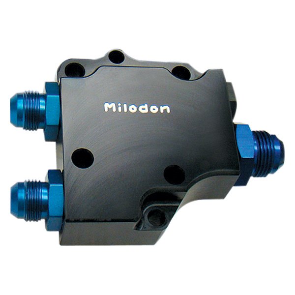

The engine part I plan on using for the (big block) oil pump cover, will be (like) one of these two (depending on which one give me more external oil pickup hose room):

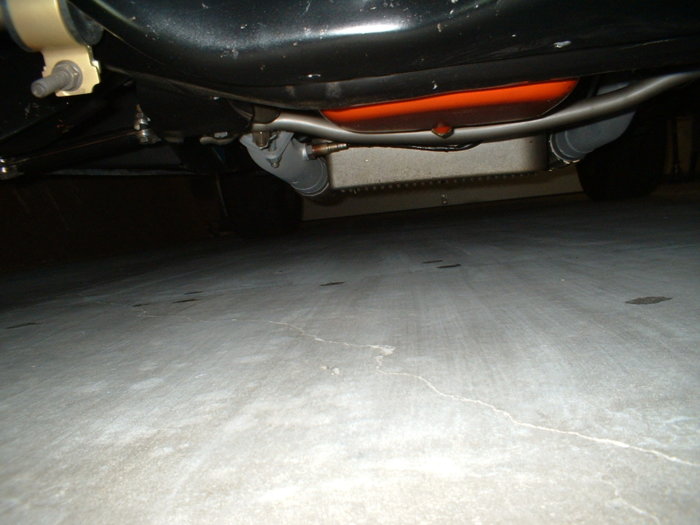

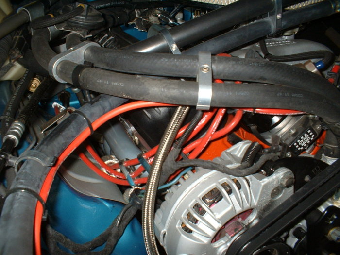

I tried to find some old pics of my car when it had a remote dual filter set up but no luck. I had the filter adapter mounted to the radiator support where the battery is now. Had a trunk mount at the time. Before that I had it mounted inside the fenderwell, above the bumper shock. Both spots worked but neither was optimal. Toughest part is running the oil lines, with a big block anyways. Now the filter is one the engine, and run a small diameter filter (equivelent of a Motorcraft FL-400S). Have to remove the fan, shroud and p.s belt to change it but what the heck, it's only once a year.
7,323
2,971

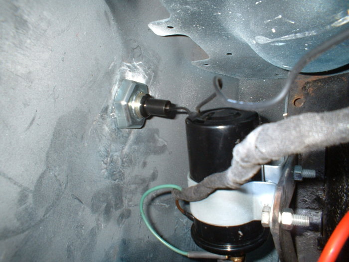

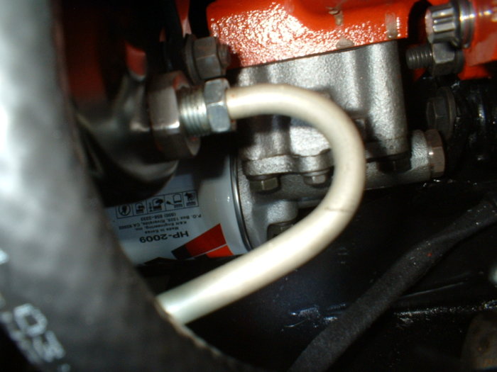

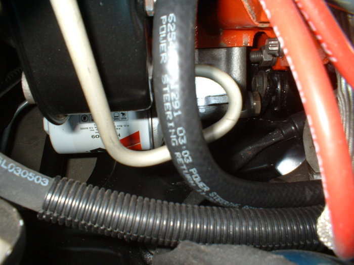

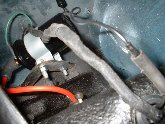

Got a couple pics, or tried to, of the oil pump. The top pump cover has an oil port that will run right into the k-frame. On the second one, the rear port will have problems with the motor mount bracket from what I can see. Possibly if the straight one was swapped for a 90 degree fitting(?) I know it's hard to see but here they are anyways.
The coil pic is just to show that with a big block, you have to use space that's available. Best location I could come up with to put the coil, up there with some remnants of the car's semi-pro street days. Does keep it away from the heat so that's one bonus:cool:

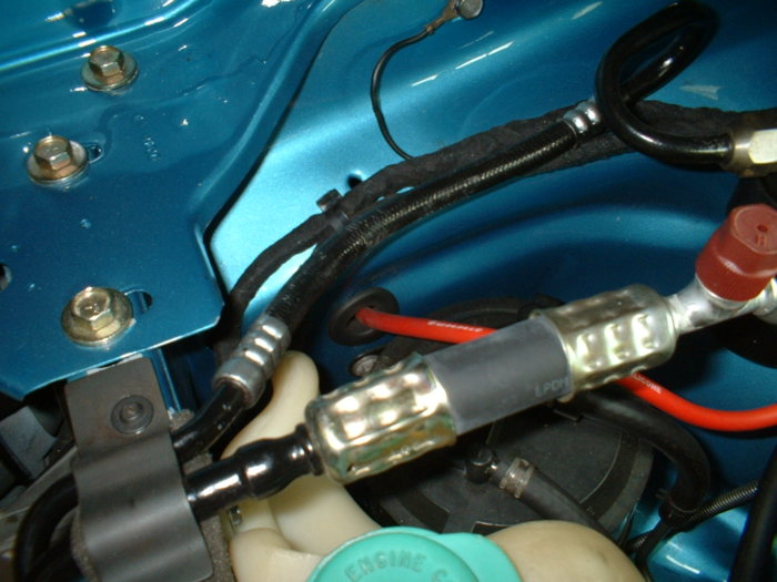

I’ve worked with trunk mounted batteries before – but not something I want to do on my station wagon. Sense it will be a daily driven car – I’m not sure I want to move the battery for the 5th Ave, either. That, as well as oil filter access makes me ponder a lot (in that area) and weighting all of the options.
’80 and newer F/M-bodies, the ignition coil fits in the passenger side rear corner of engine compartment – just below the washer tank – and sounds like a great place to keep it on the 5th Ave. The wagon, placing the coil in the same general location as your car – might not be a bad idea.
How is your coil wire run to the engine?
7,323
2,971
Well, it's obviously a long coil wire. I actually made it from a plug wire by crimping the correct terminals on and coil boot, along with extending the primary wiring. I ran the wire through a grommet where the side marker wiring used to go. (Ran that, and the coil primary harness, in a different location, under the coolant reservoir) The bracket the coil is bolted to is a hold over from the cars previous life (along with that square tubing along the fender flange) back in the early '90's yet. At one time, the charcoal canister was attached to it.

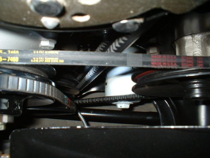

On the oil pump clearance. I'm running a Milodon high volume pump so it sticks out farther than stock. Had to clearance/reshape the area under the oil filter housing for room.
When I did the original big block swap in '89, there was no Schumacher mounts. Used stock BB spool engine brackets from a '73 or newer something or another. Cut the V-8 k-frame brackets off a K at the scrap yard, cut the S6 ones off mine and welded the V-8 ones on. I looked at a dozen V-8 K's that day and couldn't find a single one that wasn't rusted out around the upper control arm mounting tower. Gotta love Wisconsin, lol. Anyways, my engine might be lower or higher than a Schumacher swap (or it might be dead on too). Pretty sure it's where it should be though. The trans of course, is bolted to a stock mount on an unmodified crossmember and the fan is dead center in the shroud.
A Milodon stock replacement pan is pretty much exactly flush with the bottom of the k-frame, or just a hair lower.

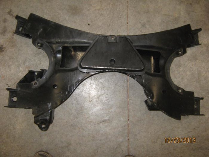

I still want to make sure there is room for pump (and external lines) on existing K-frame, though.
Most likely, I plan on installing a K-frame skid plate – of some nature – but one might not be needed. These are examples of factory skid plates (which are being repop’ed) – but one was not ever factory installed on an FMJ vehicle.
I will want to make sure the larger sway bar will work (fit) with a skid plate, before welding one in.

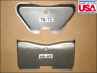

Pics swiped from the internet
E-body K-Frame.

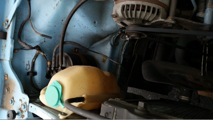

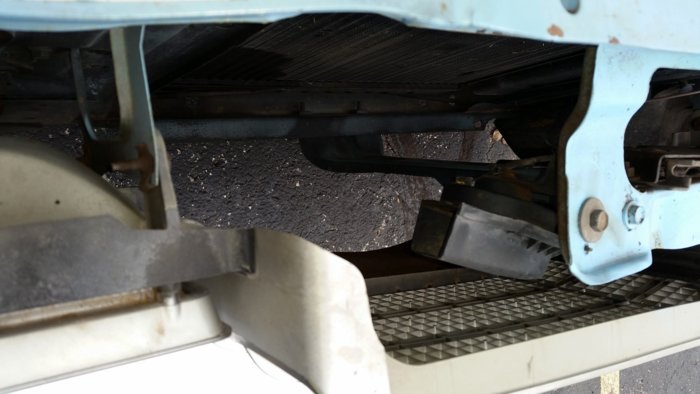

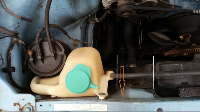

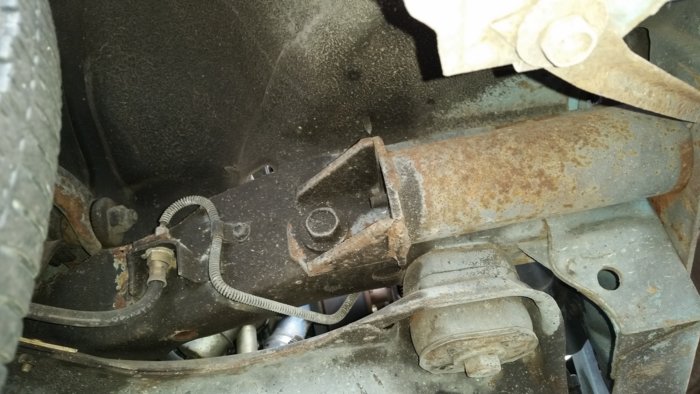

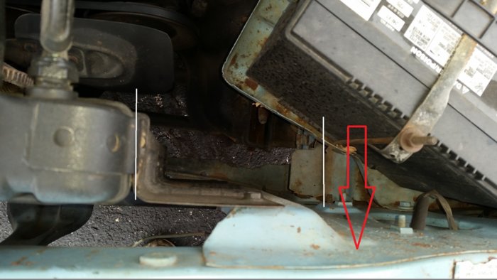

I drove my ’77 wagon today – so went ahead and took some pictures.
First of all, this car came from factory with a 318 and with no A/C. It has an 18” wide radiator. Obviously, the 26” radiator is wider – but is different in two different areas.
The first one is the radiator itself.
The second item is the two core support brackets the radiator bolts to are different (the first two pictures, marked by red and orange arrows). The current width of my 18” radiator and approximate width of 26” radiator is marked by white lines.

There is not much room in front of the radiator. Also, I’m hesitant to put anything there, except for coolers (transmission and engine oil) – mainly because I don’t want them seen through the grill.
Pictures behind L/F fender
Behind R/F fender

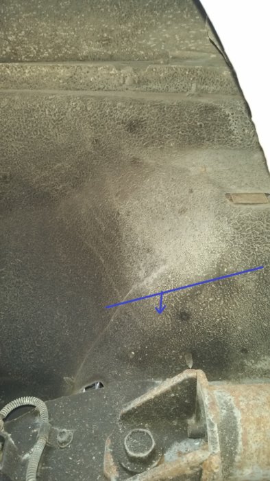

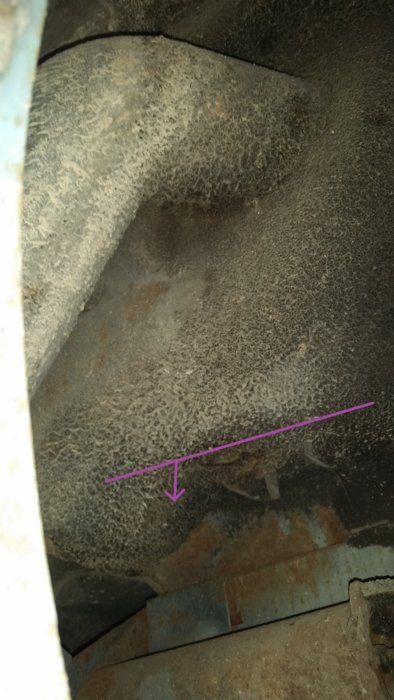

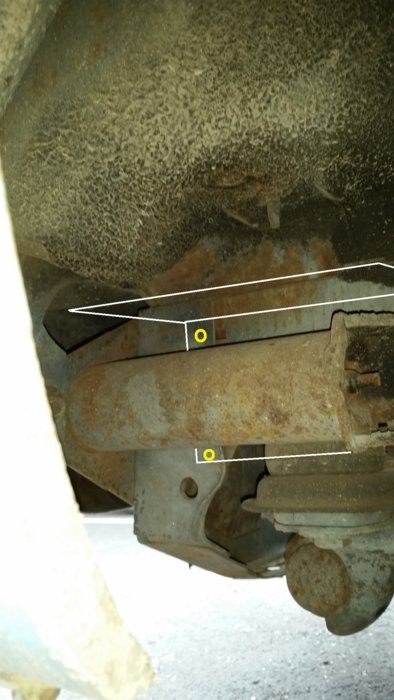

Looking at these pictures, I see two areas to mount filters (that is not underhood).
The first there is a (more or less) level section on inner fender which a person could bolt to (see blue and purple lines, above).
The second idea I have would be to take some sheet steel and bolt it behind the bumper shock, then angle it over it and towards the outside - Then attach filters to it.
After looking at things, now, I’m leaning towards the second option.

A dual setup will fit inside the wheelwell, even with the bumper shock. It doesn't leave a tn of room but it isn't bad. That's where I had mine for a while (when I had a remote filter). The oil lines ran up, over and out through the fresh air intake hole next to the battery. Was it that asthetically pleasing to the eye, no it was not but, at the time, it did the job.

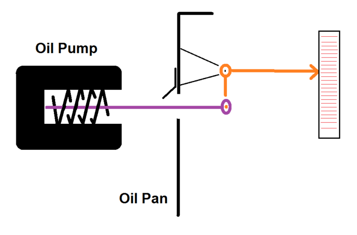

Going back to what 4SpeedJim said about oil volume:
My younger brother used to work for a major race car engine builder in Tulsa OK. They mainly worked on Chebys, but did a great job on whatever came into the shop (Sprint car, drag boat, you name it). They bored out a 340 block I had, 30+ years ago, and my brother pulled me aside to show me a tool the shop made to check oil pump capacity. In this case, it was a high winding sprint car cheby. They made a tool and welded onto e side of an oil pan.
The hole was just open, in this case. They knew what the oil pressure release valve position was when engine was off (0 PSI oil pressure) and what position it was in when full open (too much oil volume). They were working on roller lifters and roller rocker arms (before those became popular) and was having problems with oil flow at really high RPM’s. In this case, they knew exactly where the oil release valve was in relation to engine RPM and oil pressure and could map out what was needed - on a dyno.
I didn’t see any of the testing take place – but it does tell me that at least some people have looked at it.
My brother also told me that basically any engine that runs the stock RPM range and uses stock valve train – doesn’t need anything but a normal pressure/normal volume oil pump. If using a radical valve train and/or exceeding factory RPM range – then (as he put it) further testing is needed before recommending an oil pump.
