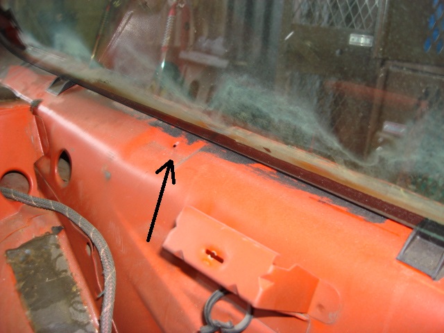

Im a bit surprised why folks are saying do it from inside the car. Here is another option.
When you remove the bracket (pic) you will see the window sits on simple locator blocks, you will also see there is no sealer on the inside or the edges.
Looking from the outside you will see how thick the sealer is.

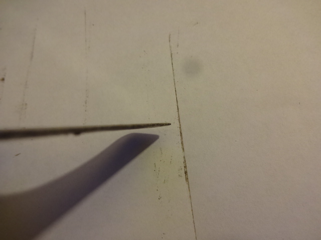

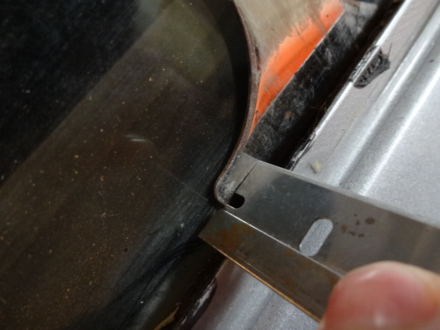

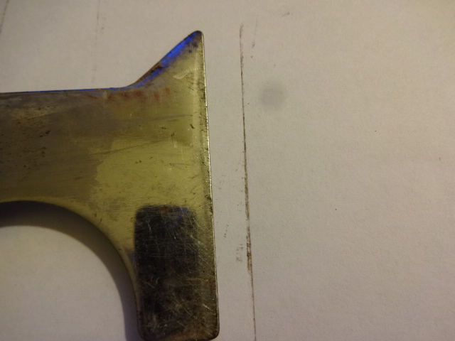

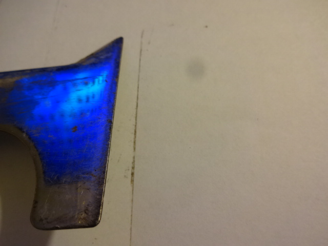

Posted a pic of the footprint of your std 5 in 1 tool which is like a thick razor blade. You can also use the type tool that holds a single razor blade if desired.

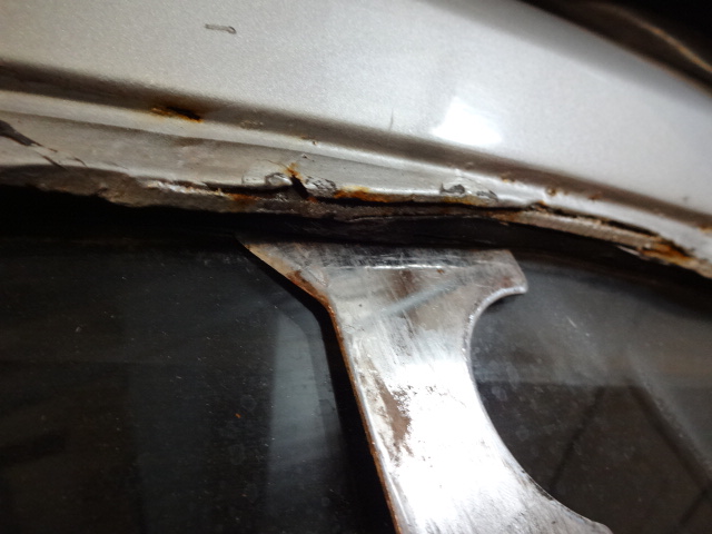

From the outside your simply running flush with the glass like you were cleaning over spray or debris from said glass but in reality your just cutting through the sealer on a smooth glass surface and its thick enough that even with the 5 in 1 tool you simply compress the sealer.
It takes me about 5 minutes a window to go three passes around evenly and then it simply pushes out. Weather the dead of winter or heat of summer matters little because you simply separating the sealer from the glass.
Then when its out a simple go around with a one sided razor blade and its good.
