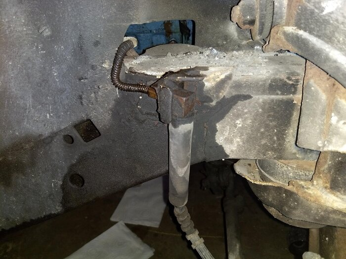

So I am wondering ...if anyone has done this before.....if it is possible to pull the retaining clip from the hose block and pull enough line through the hole with it connected to the block so as to hold the line (and its siezed-on fitting) in place while turning the HOSE assembly off?
Seen this done online but in those cases the bracket was bolted to the frame. On the Dippy, the brake block is surrounded by welded bracket.......if I can pull enough line through maybe it will spin off?
If this has been tried and doesnt work I wont bother trying....LOL
Havent tried heat yet.....have to wait til my supply of 1/16" thick 7/16" ID crush washers arrive later this week......so I can pull the hose off the caliper....
Praying that maybe the end run of spinning it off will work? Would have to be able to pull a good couple inches thru though.....

Use the mopar copper washers if you can still get them. They were the correct thickness and softness. I think the part number is 6030084
