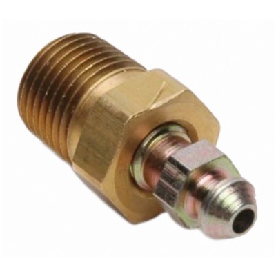

Hopefully you can get the bleeder loose. One "trick" for bleeders before they're siezed. Make sure to cap the hole to keep water, salt and other misc crap out. It's amazing how ones that have been capped since day one come loose quite often, while ones that have been uncapped for one winter are stuck solid. The salt goes down the hole and out the bleed hole and rots the bleeder tight below the threads. If worse comes to worse and it breaks off, there are bleeder repair kits where you drill the holes out to a certain size, tap pipe threads, then a brass insert screws in that has a bleeder screw. Normally at work we just end up replacing the caliper(s) or wheel cylinders with hopeless bleeders but that comes down to a labor cost to repair vs replace the assembly and replace always wins out.

If the calipers have been on there for a while it's usually best to replace them in pairs. For the cost of them it's usually not worth messing around with when the bleeder breaks off. M bodies aren't too bad for it but some cars you go through the extra work only to see they're leaking from the piston seal the next time they're apart.

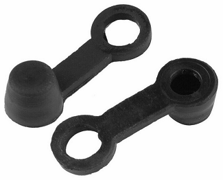

One "trick" for bleeders before they're seized. Make sure to cap the hole to keep water, salt and other misc crap out. It's amazing how ones that have been capped since day one come loose quite often, while ones that have been uncapped for one winter are stuck solid.
I agree with this 100%.
There are a number of different designs/styles. I don't think it matters much as to which - but if car sits outside or sees any bad weather, get something to cover those bleeders!
View attachment 40969 View attachment 40970 View attachment 40971
Those simple little caps do so much. I've had bleeders that were on 15-20 year old vehicles come loose with no problem that were capped, even tiny ones on rear wheel cylinders. A few have needed a "turbo" socket or Vise-Grip's from the hex being rotted away but they still came loose. Have had bleeders seized beyond any hope after one year (basically one winter of salt around here) because whoever worked on it last, didn't put caps on.:mad:
Haven't seen were to get them but, the type that cover the entire bleeder, hex and all, are the best. A few OEM's use them from the factory. Providing they aren't compromised (i.e. rotted), when pulling the cap off, the bleeder looks like brand new yet. Doesn't hurt to put a little anti-seize on the threads when replacing a caliper, or when the bleeder is out for some reason. Same goes for the tube nuts. A little anti-seize on the brake line, under the tube nut, and the nut threads themselves, goes a long way to helping future repairs.
