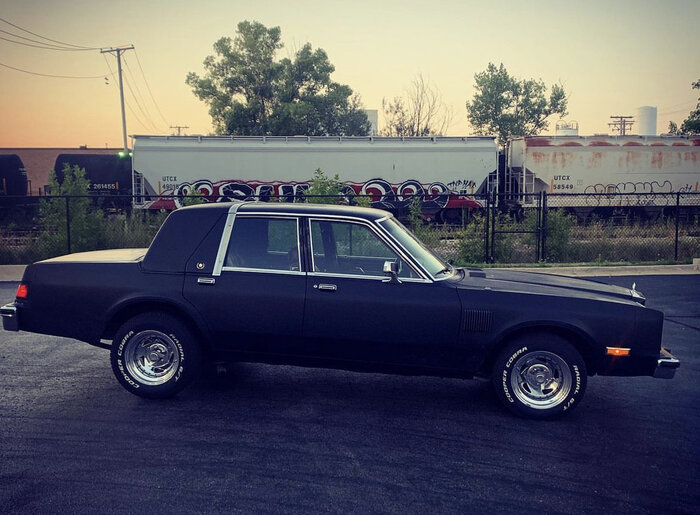

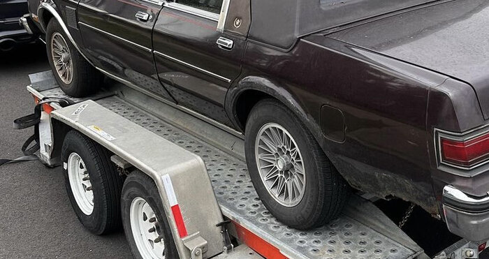

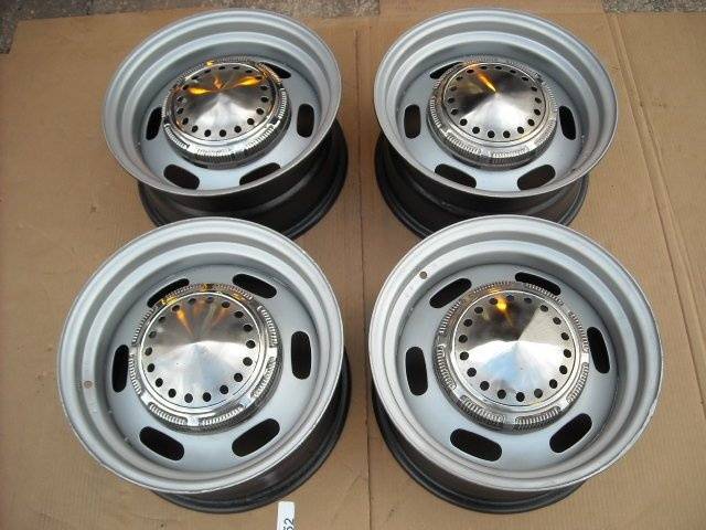

Poverty/dog dish caps like these (top photo) are pretty popular with Mopar guys. If you can find a set of Mopar rims (some of these cars came with pretty cool rims) that would be another option; like these snow flake wheels (bottom photo).

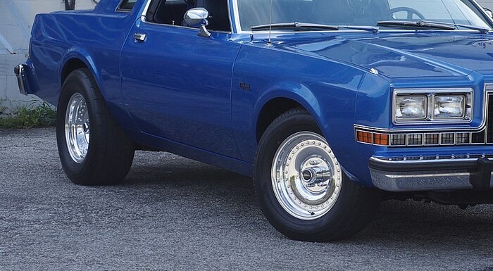

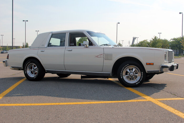

Cragar S/S wheels compliment Fifth Avenues with all the chrome really well.

Thanks y'all. I've looked online and I've seen several contradicting sizes so I wasn't sure. Duke I've seen yours in Pinterest and that was the look I was going for but all of yalls look great.

15x8s fit real nice, 255/60 tires fit with with plenty of room.
