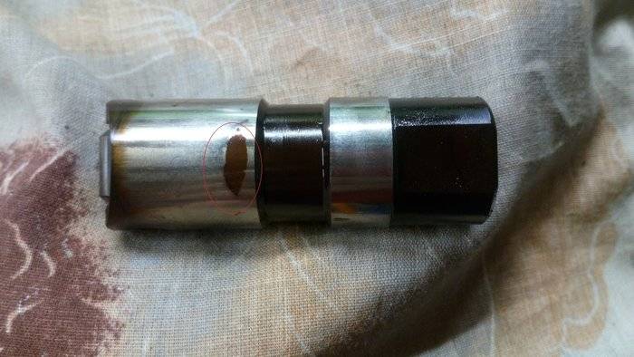

Hi Guys,
All my roller lifters are worn like the photo, its like its gone through the hardening. Is this normal wear or do they need to be replaced?
Thanks
Bruce
1,492
That is not at a critical wear area. I doubt it will even cause an oil usage problem there, either. It kinda looks more like a defect in lifter casting more than anything else. That problem I wouldn’t worry about. Other things, yes.
The things to look for is any roughness or looseness in the roller, any scoring along sides of lifter (scratches going lengthwise), the lifter operation itself and for rust.
The only specifications I could find are:
Lifter body diameter: 22.949 – 22.962 mm (0.9035 – 0.9040 inch)
Clearance in block: 0.0279 – 0.0610 mm (0.0011 – 0.0024 inch)
Dry lash: 1.524 – 5.334 mm (0.060 – 0.210 inch)
The spot in question shouldn’t matter one bit.

Probably be a good idea to stick them in the hole they came from if you havent mixed them up. No biggy if you did as long as they move free and consistent hole to hole.

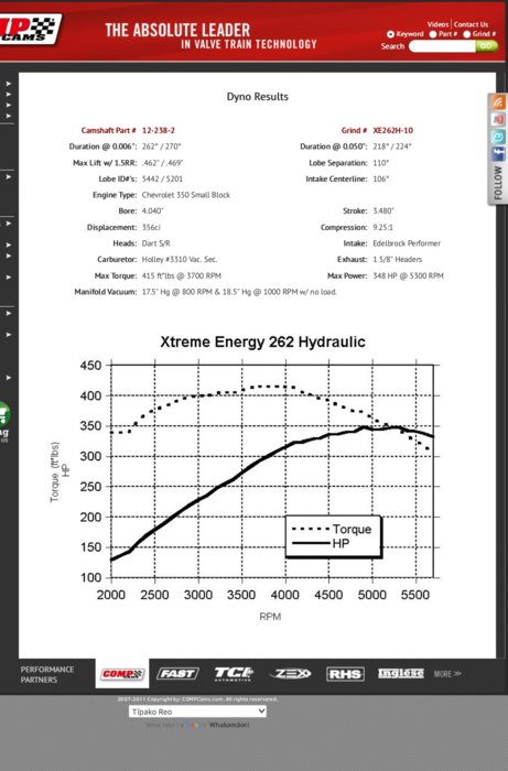

Here is the comp xe262, advertised duration same as my roller, but 50thou specs very different. Can you compare rollers and flat tappet cams?

The XE 262 has specs of 262/270/110/+4,with .050s of 218/224.Lifts are .462/.469
Your roller is .................262/270/110/+2,with .050s of 209/217 and lifts of .496.
Ok the XE has typical hi-performance ramps of 262 less 218=44*
Your roller has ramps of 262 less 209= 53*. That is 53 less 44=9 degrees more ramp. And they stole those 9+ degrees from the where it counts; the .050s. This makes your roller idle the same as the XE, but it is more than 1 cam size smaller (1 cam size is about 7*),when comparing the .050s. That means if the rest of the lobes are comparable, then the roller will power-peak about 200 rpm sooner, and typically 15 horsepower down. Please note; I said if the rest of the roller lobe compares to the FTH. Often rollers start off gentle like yours, then accelerate faster than the FTH, and dwell longer over the nose. This reduces peak horsepower, but broadens the powerband for more average power. This usually helps an automatic equipped car which has a .59 shift-split on the 1-2. Meaning the Rs will drop to .59 of the shift-rpm at the shift.
Take a look at the power curve of the XE that you provided. Don't look at the absolute number, but try to imagine where the power-peak is. I estimate at 5300. Then notice how rapidly the power falls off after that, and compare that to how quickly the combo builds power below that. Now, for low-ET,with an automatic you will need to shift well after the power peak to come in at a similar power level. This will keep the car accelerating smoothly. THe graph only goes to 5700, so lets work it out shifting at 5700. 5700 x .59=3363. So compare the outgoing power at 5700 (I estimate 340) to the incoming power at 3363 (I estimate 255). So you can see that there is a 85 horsepower drop during the shift. This will cause the car to momentarily slow down as the engine struggles back from the basement. A 4 speed has a 1-2 split of .718, so it will drop to 4093rpm, and the power there look like about 325, and so the power drop with it is just 15hp, hardly noticeable. This is why automatic cars need different cams than 4 speeds.
Ok so what should the shift-rpm be. Well we would have to extrapolate the top of the power curve out a fair ways. I'll guess 6000 and I'll guess the power there, to be 310. Ok now .59 x 6000 = 3540, and the power there I estimate at 275. So now we're down just 35hp. So we need to rev a little higher yet. Let's try 6200. I'll call it 290outgoing and .59 of 6200 is 3660, and the power there looks to be 285, so close enough. So with the XE 262, the 1-2 shift wants to be 6200 with a standard ratio Torqueflite.
Ok now we have no power-curve for your roller, but you can see how this works.
Lets say your roller makes 15 hp less than the XE at peak of only 5100, remember your .050 is 9*less.
But lets say your roller ramps are faster than his, so that your power at 6200 is greater, and your power is greater at 3660 as well. Well it could work out that your roller makes the same average power is that XE. I'm not saying it will. I am saying a roller cam could. I just don't know about yours.
