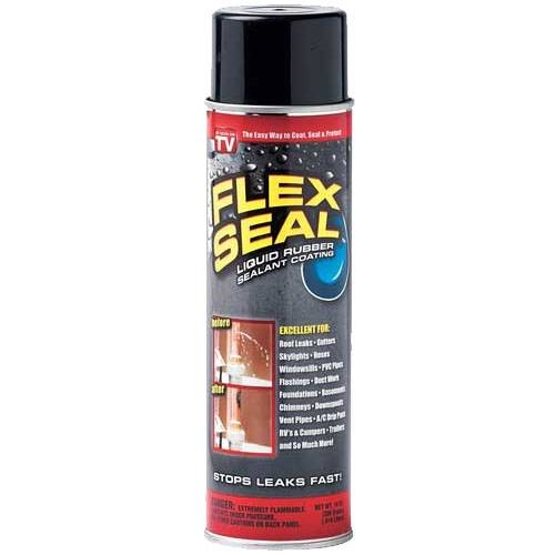

I have a set of used ones.
Been thinking with a small brush, gluing/contact cement any cracks, then buying some 'Flex Seal'
It's a rubber/flexable coating.
Maybe a couple thin coats and try it out.
Just have to make sure the surface is clean
7,346
2,991
Worth a shot. If it doesn't work out, you can always build a boat out of window screen and use up the rest of the can:D
