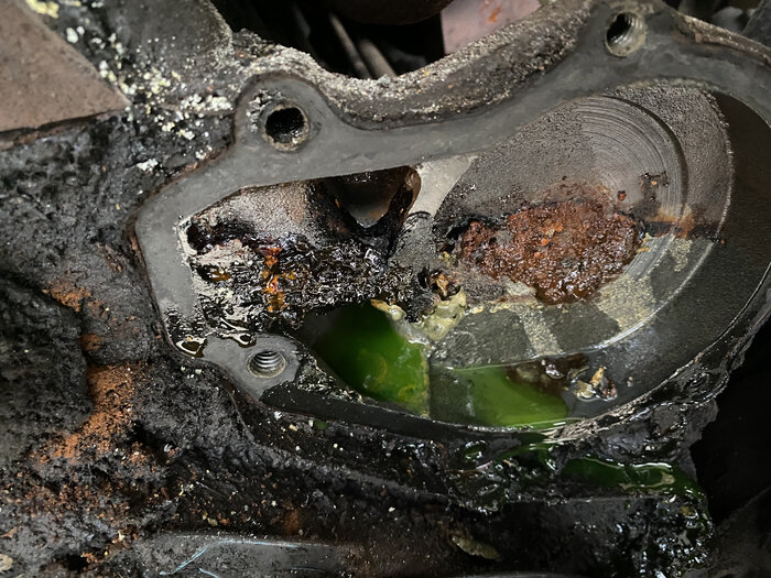

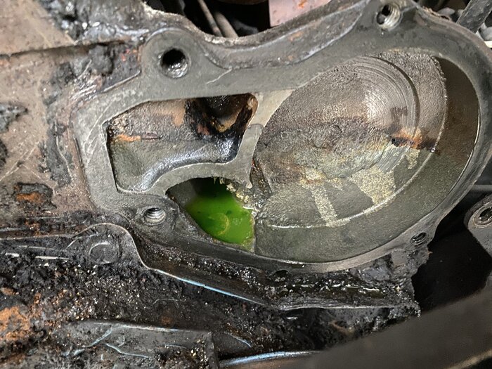

Happy 2021! 81 slant 6 question In the upper left of the water pump when removing I noticed an oily glob, and even when that bolt came out it looked like it had some oil on it. Is that in anyway normal when swapping water pumps? Car has not run in 15-20 years so maybe just something settled where it normally would not? At least the fluid has been green...
It's just oil that seeped in over the years from the obviously leaking valve cover and timing cover gaskets. Probably seeped into the pump cavity as the engine sat for the past 20 years and sat at the top of the coolant level (which looks to be about 1/2 way up the pump cavity) If it had been in there when the engine was still running, the coolant would also have oil in it and would most likely look like chocolate milk. At least from what I can see in the photo's, it's nothing to worry about That said, it'd be a good idea to check the rest of the cooling passages for evidence of oil, just to be sure there's not a crack somewhere. Chances of that are very slim and normally the leak goes the other way, pressurized coolant into the oil, not vice versa.
I also believe you are okay, with a good flush and new water pump and gaskets. Remember distilled water with your coolant mix.
