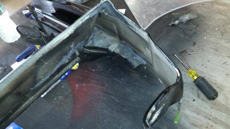

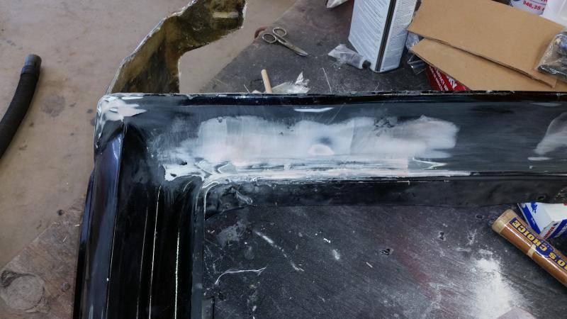

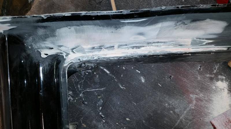

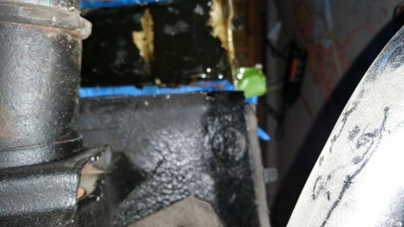

Ya i was thinking the same thing one thing i found out was you can smooth out the parts with vaporized acitone sound dangerous but not realy . Any way here are the first photos of the extentions im filling the cracks with epoxie then fiber glassing the insides . The support structure is plastic and also stapled to the extention just in case you need to deal with them on on your cars . Also i have those nasty ones from replica plastics they are junk but if you had to use them they need some work . ( and i might if this doesnt work)

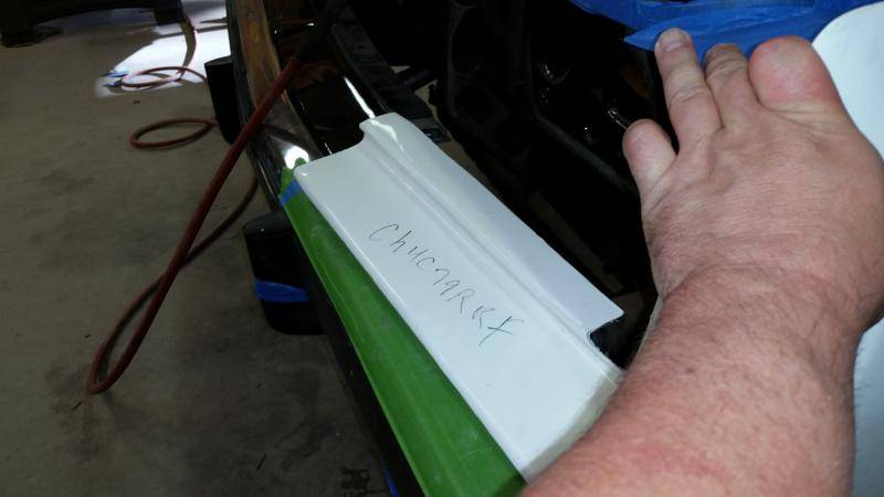

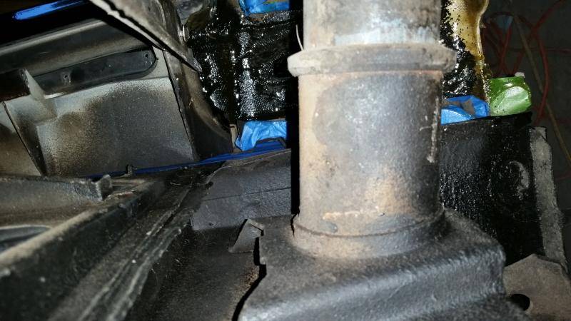

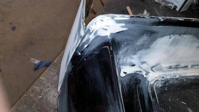

Ok here is the next installment . What i have done so far is to epoxy the cracks to stabilize the right extention with jb weld ( probably not the best way it takes too long to set ) i have sin

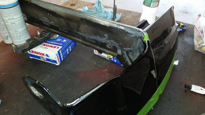

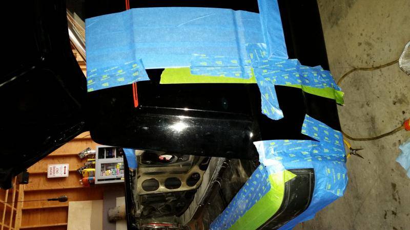

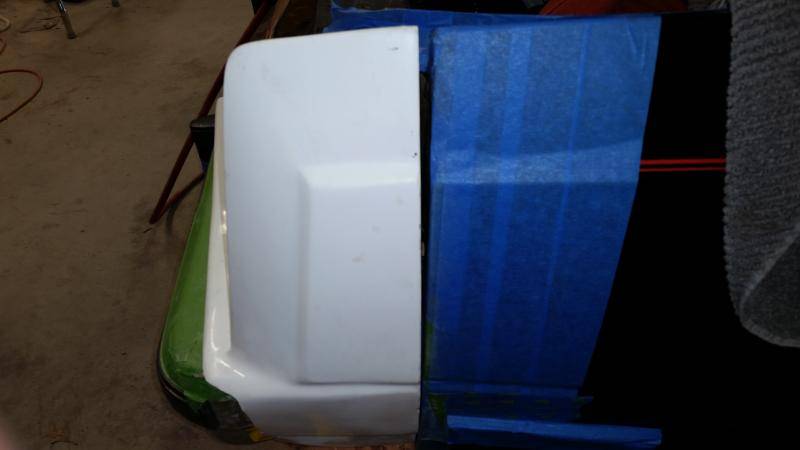

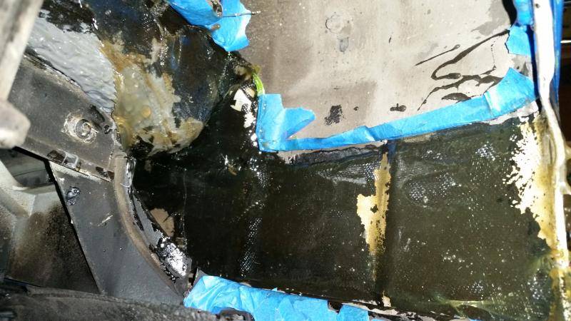

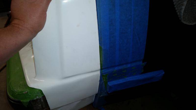

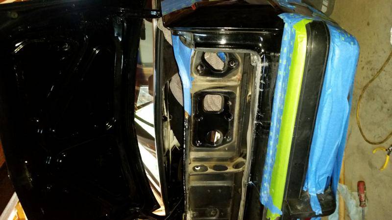

since bought a 3m product for urathane bumper covers ,ill give that a try on the left side today i remounted the extention to the rear quarter so i could lock in the shape while i reinforce the peice more from the back side with resin and fiberglass mat so far so good . Here is some photos

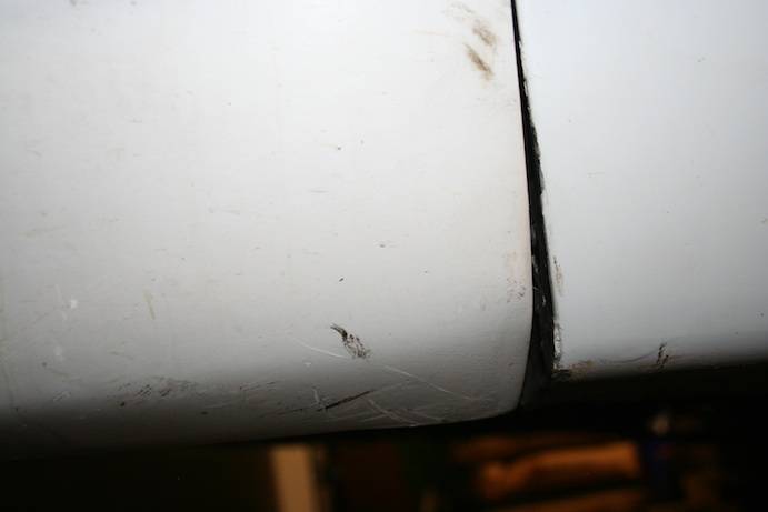

Also here is some info for the folks that bought the replica plastics crap parts . This is what i have found out about the parts and the moulding process the guy used . Frist off for those that have not seen these parts you can not put these on without modifying and reworking the parts extensively . Second when he molded these parts they were not molded on the car thats why they do not fit ( not even close ) DO NOT BUY THESE UNLESS YOUVE GOT PATENCE AND TIME TO REWORK THEM ! Anyway what im trying acomplish is the make bolt on no bs extentions so if this works out to my satisfaction anybody who needs the will have another source and i will be looking for the interior parts that support the quater extention so they can be integeral with the new parts . I will post photos of the replica plastic pieces to show how bad these fit once the originals can be removed .

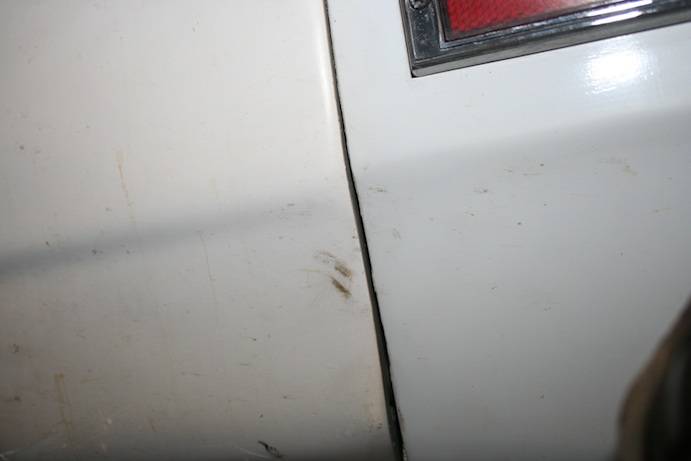

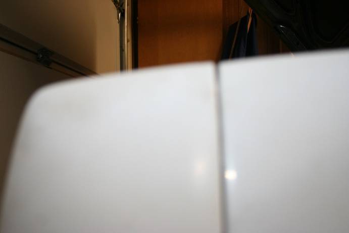

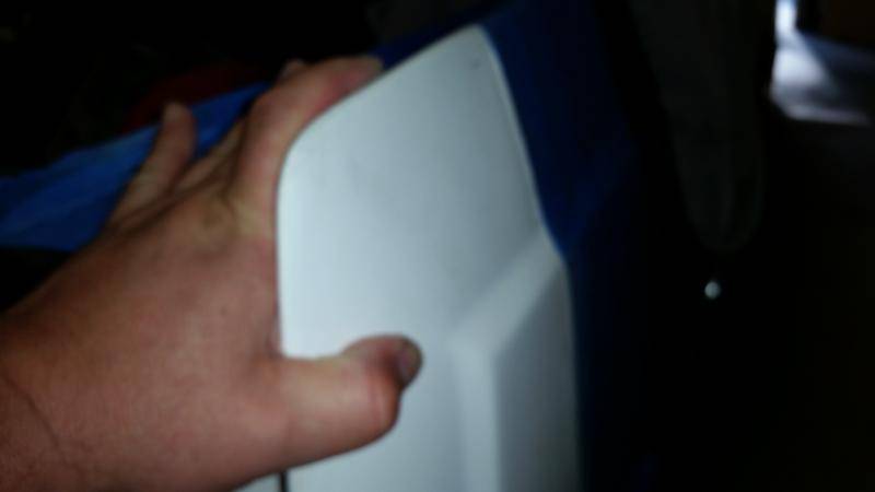

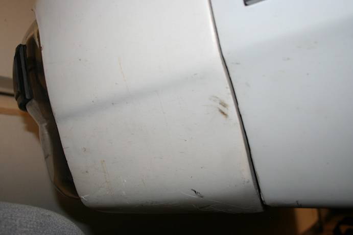

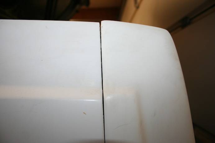

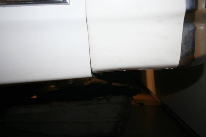

Here's the pics of whatever is on my car, as promised. Again, I don't know if these are the Replica Plastics repops or a cut-up VFN rear piece, or something else. I have no idea. But they are fiberglass. I guess the fit isn't quite exactly "too large" as much as it is just that most of the bodylines don't line up very well. The main thing is on the driver's side, the top is a good quarter inch above the top of the quarter panel (the first two pics), then on both sides, the bottom is a little too short (high). They're certainly serviceable for my street/strip car, but whatever they are, for someone expecting perfect/factory/show, they would definitely be a disappointment. Before I Plasti-Dip the car, I'll sort them out so they'll look good enough.
Sorry, the 2nd to last pic was out of focus, but it's showing that on the passenger's side, the top of the piece is aligned fine with the top of the quarter, unlike on the driver's side.

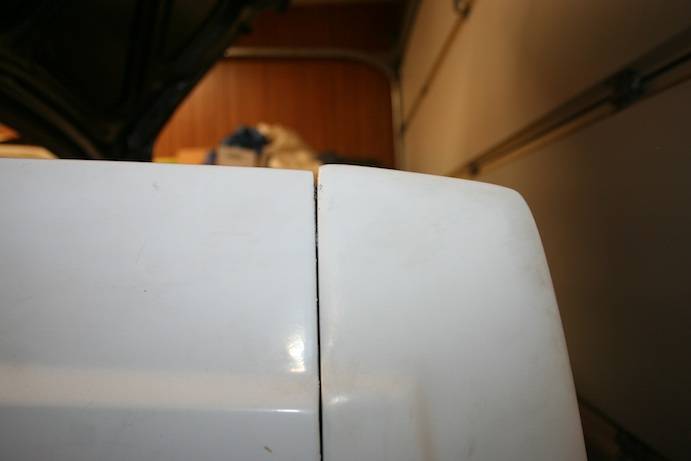

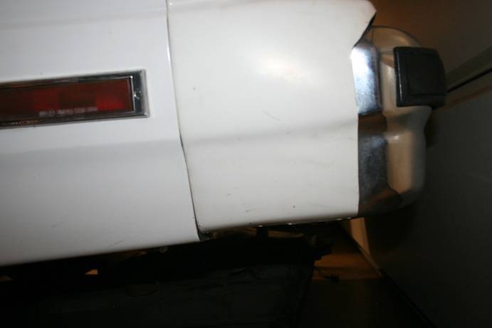

Thanks for posting those photos 72 dodge here is what mine look like . The only thing i can say is wtf .

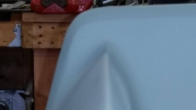

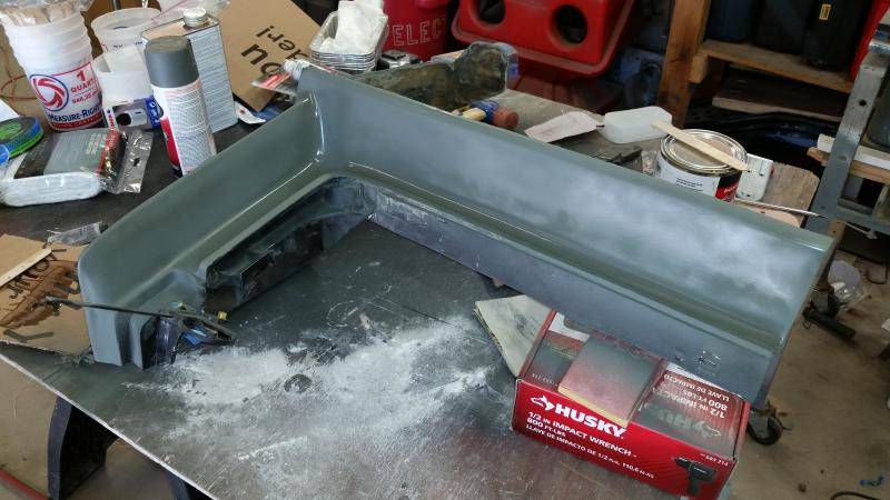

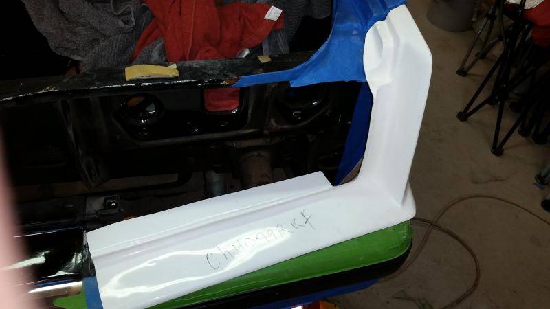

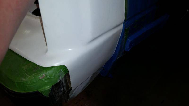

Ok here is the next instalment most of the body work is done . There is some small details to address and then mold making time . One note most of you if decide to do something to your extentions your going to find that no matter how good they look they are going to gum up your sand paper do not use 80 grit on these parts they will dissapear fast . My first sanding was with 100 then 220 then i put them in etching primer . From here ive got to epoxy the lower mounts to the extention( this way i can mold the bolts in with the peice , and they will bolt up like factory parts ) .
Well winter is here and I have to bag this project time to put the baby to bed it's too cold inside to risk more cracking we'll pick it up in the spring. The one thing that I've learned about these pieces (of crap) extentions is no mater how you baby them the will always present another Crack and sanding them is something that requires self control this has taken way longer than I thought but hey when your swinging but the short hair it has to hurt a little
