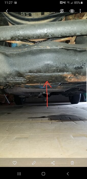

Safe front end jack point?
JBFury
May 21, 2021
46
16
Ohio
Front of car, before the oil pan. Seems to be part of the frame, but I'd rather be safe and check.
Mikes5thAve
Mar 3, 2020
1,718
705
Yes if you are jacking whole front at once. You can also use where the frame comes to a T behind the front wheels if you are doing one side at a time or the spare tire jack points on the rocker panel if you are using one of those small hydraulic jacks.
