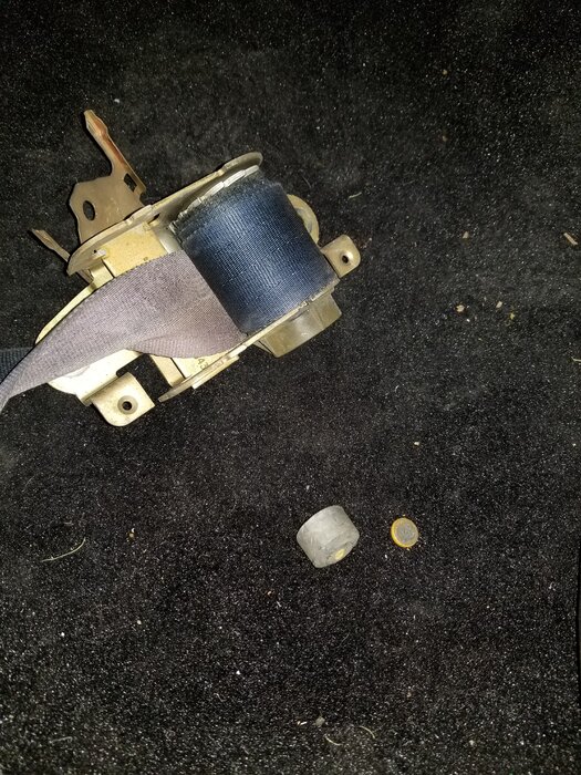

Was putting new carpet and headliner in the 76 Volare this last weekend and when I went to reinstall the passenger seat belt, I noticed the weighted pendulum for the locking mechanism was just lying there. What are my options? I'm assuming gluing the plastic pendulum piece that snapped is not advisable. So is that piece replaceable (doesn't look like it's meant to be opened up and worked on)? I'm assuming the best approach is either to buy a used direct replacement from a parts car or buy a new universal retro seat belt and try to force it (but it will be new).
2,992
Might be worth a shot to get a hold of this place and see if they can repair it. One problem with used belts is, the webbing is 40+ years old and may not do the job if the unthinkable happens. Of course, rewebbing is possible though. Not sure about universal replacements. It'd be better than nothing but it'd be my last choice.

Good info, thank you! I'll teach out to both. Still a little scared about the pendulum being plastic... now I'm half worried about the driver side. 40yr old plastic piece kicking off the locking mechanism. Scary stuff.

Broken piece
2,992
You'd think something as important as a seat belt, they'd be made of metal and not plastic. Without the pendulum the seat belt is useless, it'll never lock.

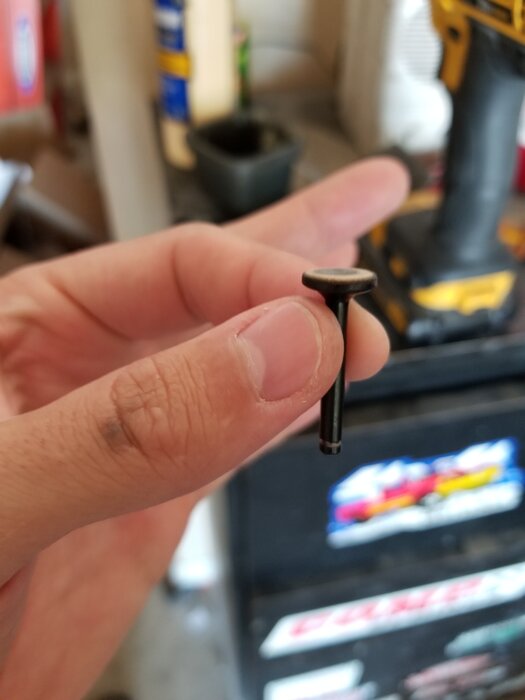

Haha, never been worried before... it's actually for the passenger side. Got a 1yr old now and just looking to the future. I'm actually trying to fix the old one by replacing the plastic with a metal piece. I'll do some tests afterwards to make sure it actually works and post some pics.

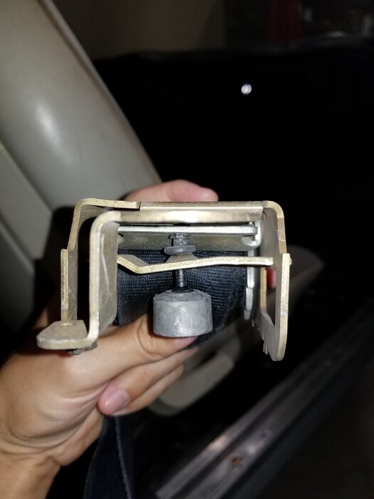

Just replaced the plastic piece with the metal and put it all back together. Seems to pass the tilt/ gravity test.

Hope your confident, they might of picked lightweight plastic for a reason. Now if you ever have an accident and it fails you will always wonder if you made the right choice.
Id have to go look, but doesnt it lock and stay locked until pressure is removed? If so even if the plastic broke in an accident it would still have done its job and only needing replaced. maybe? Im just thinking here.

Good to know there's still a separate lap belt restraint as a backup. I do have a replacement system to install once I start consistently driving with a passenger/ once the kid is old enough to ride in the front seat. Right now I drive on my own 99% of the time. That being said, it's a pretty simple system and I can't imagine why a metal pendulum connection would make a difference from plastic. Maybe the plastic breaks in the event of an accident and it can't be reused? I'd assume it's because that piece is easier to make in plastic and allows for quieter operation.

Im sure your part is fine and actually pretty impressive you fabbed one up so quickly.
Like you wrote, maybe they are meant to break in a bad bad wreck so the whole belt gets replaced, im sure an old body shop worker or dealer guy would know.
2,992
On the later cars, there's only the roof mounted retractor. The lap belt is bolted to the floor so if the roof mounted one doesn't do it's job, you're screwed unless the belt doesn't slide through the buckle on impact.
You may be on to something about the pendulum being made to break on a hard impact. After something like that, the belts should be replaced because the webbing can be compromised if the sudden stop is severe enough to break the plastic.
