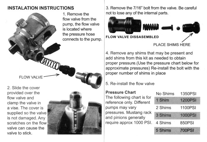

As 'volare 1977' points out, you can make it stiffer, which will give you a more planned/anticipated kind of a feel. You could certainly go to an aftermarket box like the Borgeson stuff (this is the approach I took with their part# 800127).
Heck, you could even chance it a bit and get a parts-store aftermarket setup that is just like the Borgenson stuff, but not purpose build like their boxes are. I hear these are actually pretty close to providing the same result, at a much lower price point.
The absolute el-cheapo approach would be to control your power steering pump pressure by installing a few extra washers in that valve that lower the output pressure of the pump. See their part# 899001. Easy install, I initially did that with my stock power steering box and the difference was clear!

the steering is too sensitive. At 50-60 MPH a sneeze could be dangerous. it responds very quickly to any actions. It is manageable but I'm interested if I have any options. There is no play in the linkages. Stiffer as volare1977 suggests is worth looking into. I did put an Autozone rebuilt Sterring gear on it and that helped by eliminating the slop. M_Body_Coupe can you describe the washer thing to me?
The 899001 is not too expensive so I am willing to try that too, or first. Does it get installed at the Power Steering Pump or at the Steering Gear?

I googled the Saginaw pump, it looks like to add the kit I would remove the High Pressure line from the back side and then remove the Nut where the line was attached. When I can get the garage above 40-50 degrees I will make sure I have enough room to do it without removing the pump.

the steering is too sensitive. At 50-60 MPH a sneeze could be dangerous. it responds very quickly to any actions... M_Body_Coupe can you describe the washer thing to me?
Yes, the washer(s) get installed in the power steering pump valve. In short, the extra washers caused the valve to meter lower pressure of fluid, which in turn means that the steering gear is less sensitive to your steering wheel inputs. The outcome being: you have less of that overpowered response and normally need to apply more steady force on the wheel to steer the car accordingly.
Let me dig up both the install instructions (although you can find that directly on their site, or even SummitRacing I think), as well as saved copy of an article from one of the Mopar mags that actually walked through the installation.
