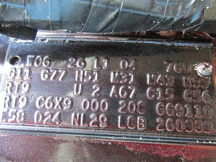

I'd like to see the fender tag on the 4-speed car.

Ive one tag off a SC and on tag on a SC, neither look like the lower stamped edge or has the odd spacing.?

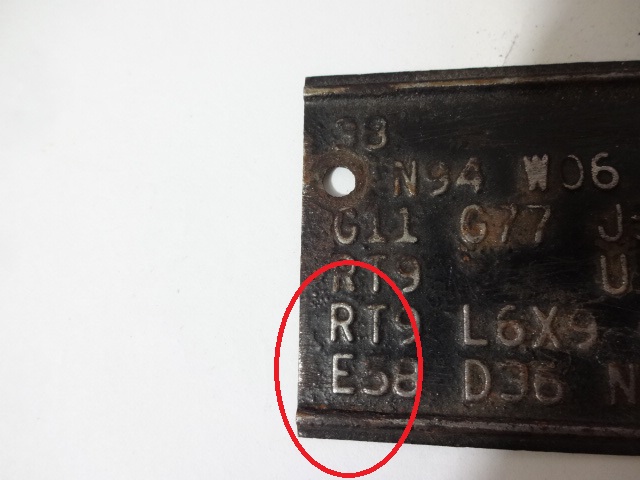

Here is an example of two different f body A57 car tags, look at the lower portion of the 7. One is straight, one has a lil hook inward. The A is different, the spacing is different, but both real.
Hell, who knows, it could be real, just alot of odd circumstances. Pretty interesting though.
We should ask DB Cooper.
2,991
I think possibly the fender tag font could be different depending on what plant the car was built at. It's a theory anyways.

I thought that was widely known, it would make no sense to swap stamp sets at the same plant unless it was a perm. change. Most f people dont even seem to think or care where there car was produced, I find that odd myself. Even fewer seem to care about the history of them.

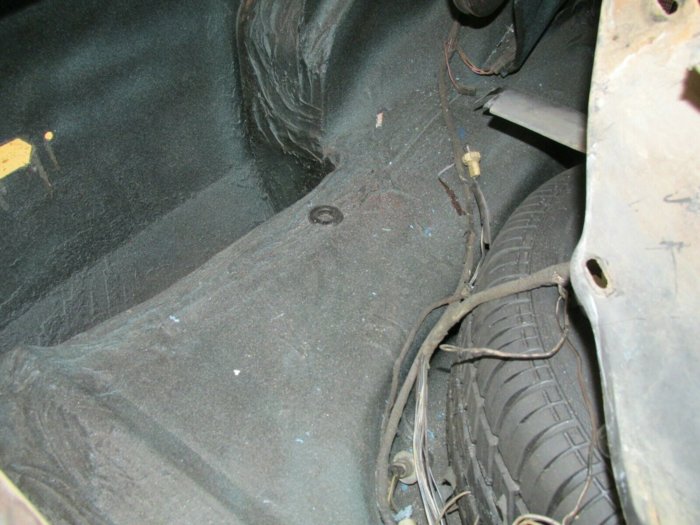

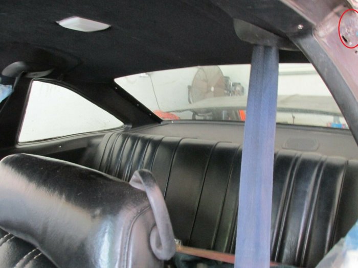

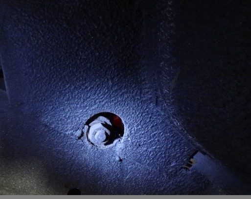

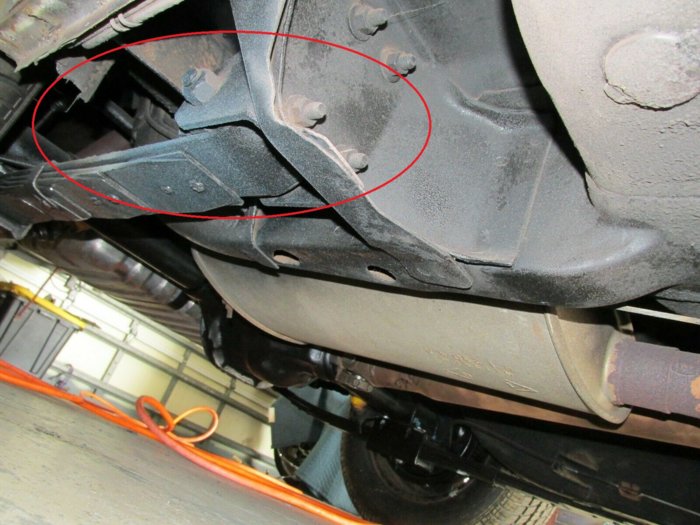

Then why does the one listed show blue paint on the leaf spring in one pic, a hint of blue on the upper door piller with the trim removed, blue paint in the trunk where the paints been scuffed.
In the vid, the rear quarters have no holes drilled for the lower spoiler caps on each side.
The whole car just dont add up. Whats missing in the trunk pic?
