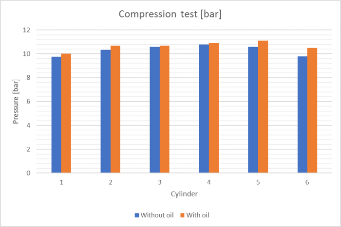

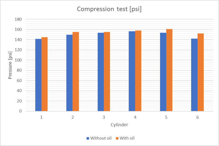

Compression looks great!
Great chart, by the way.

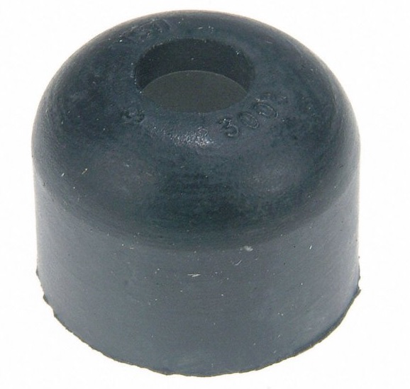

This is what the original valve seals will look like
This design is snug on the valve stem and will move when the valve moves and is referred to an umbrella seal (shields oil splash like an umbrella).

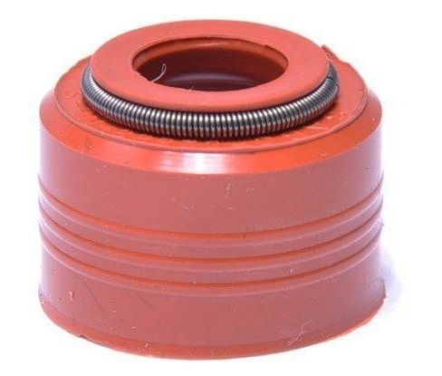

Newer design valve seals look like this
This design is made to press snugly on the valve guide. The inner part wipes oil away when valve moves up/down. This design is not known to get brittle and shatter like the above design does – but the inner seal can wear in time where it contacts the valve stem. This design might require some machine work on valve guides to fit correctly.
This design is referred to positive seal.
Personally, I prefer the umbrella design for I like to see a smidge of oil reach the valve guide itself. The positive seal design allows for no oil to reach the valve guide. This might be good for newer engines but for our design engines – I feel a bit of oil helps (which is my opinion, only).
Now if a person is using a newer cylinder head, like aftermarket aluminum head – then positive seals would be the way to go, sense the valve guides will be of a newer material that will handle the lack of oil.
Note: you do have some piston ring wear – but with your compression readings as high as they are – I don’t think it will be cost effective to replace the rings, at this time. I would change the valve seals and recheck your oil consumption rate.
