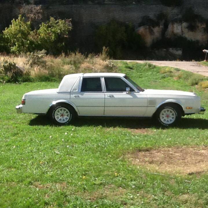

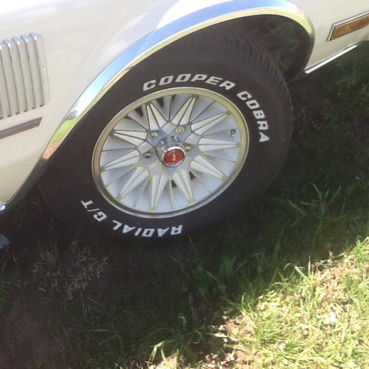

here you go

WOW! Those look AMAZING! Very inspirational. I wasn't the one doing the work, so it's easier for me to say, but I'd say it was all worth it. Those really MAKE that car! Great job!

Nice work,your wheels came out beautiful,I bet it all seems worth it now.
