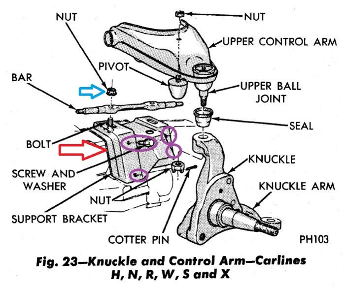

    If I understand what you are saying, the bolt touching the nut indicated by blue arrow, spins below the support bracket (red arrow)?
    If so, separate the upper ball joint from knuckle, push control arm upwards, then remove the 4 bolts that attach support bracket to K-frame (purple circles) and upper shock nut.
    The upper control arm will come off car with the support bracket.
    Then take that assembly to a vice to extract the nut (or use a nut cracker, or torch, or . . .).
    Matter of fact, both support brackets (red arrow) must be removed to remove K-frame from car, to begin with.
    I would generously apply penetrating oil to all exposed bolts, nuts, etc., several times before disassembly. Drilling holes in crossmember at the bolt locations – is also advisable.
    If a K-frame to frame rail nut breaks loose (welds break from frame rail) and spins in frame rail – there is not a lot of options, at that point.
