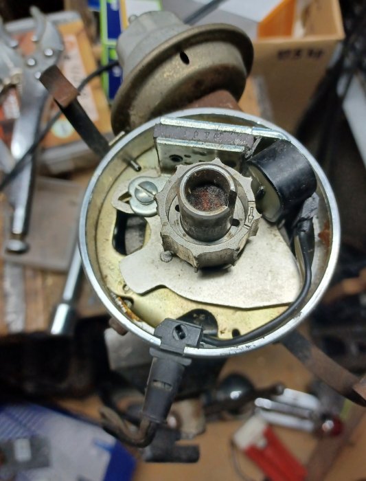

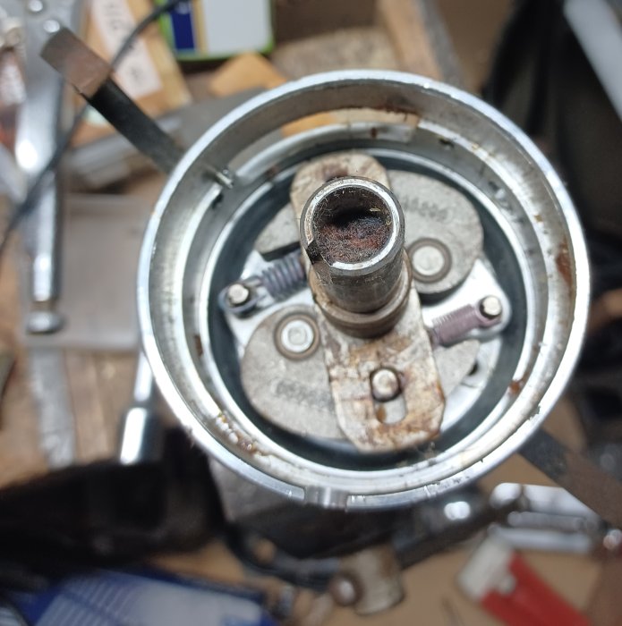

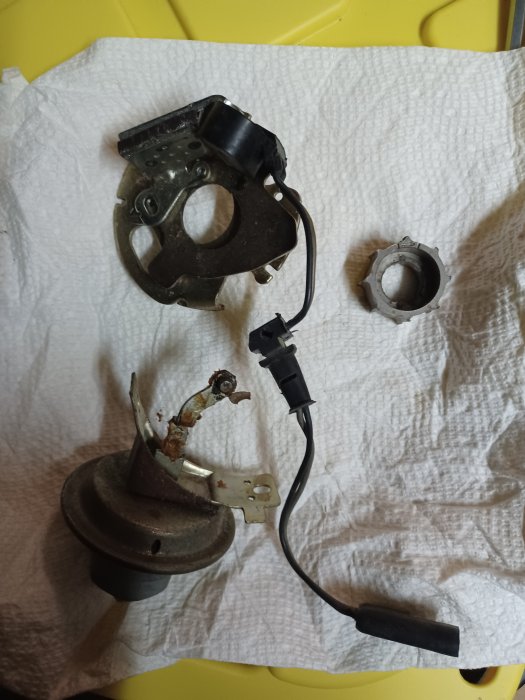

I couldn't sit through that whole video but it looked like he was only dealing with a points distributor. It doesn't need to come all apart like that for the pickup only the top pieces. But distributor does need to come out to do it.
On a spare one I had I just pulled it apart in under 5 minutes so it's a pretty easy job.
Remove star wheel and don't loose the roll pin like I did, remove vacuum advance pod, remove pickup. You have to watch which way the star wheel goes to put it back together in the right spot and adjust the air gap of the pickup. And re time it when it goes back in the car.
Order parts for like an 84 D150. The stock Diplomat one is a different pickup then vacuum distributors use.
