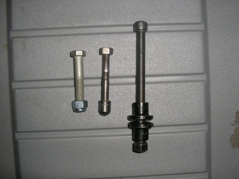

Question? I got the kit from solidbushings a while back. The pic below shows some center spring guide bolts.
L to R:
Bolt that comes with the SB Kit
Bolt that came with the SS Springs
Stock bolt for F-body springs and iso set up.
My current setup has SS Springs with the iso crap. So, the bolt from the SB kit will not work in the SS Springs.
I dont mind changing out springs and the front hanger to keep from fabbing something with the SB kit and SS Springs.
The question is, if I go to XHD e-body springs, What is the size of the center spring guide bolt that comes with them? Is it the same diameter as bolts numbers 1 and 3 in the pic below?

XHD springs come with the same as the SS springs (num. 2). I bought new spring perches from Mancini and the hole was still a little big, Welded in some spacers and redrilled correct size. Hope this helps.

I have used allen head bolts to hold the spring pack together and the round allen head centers the spring perch. This works with 8 3/4 rears or when using some aftermarket perches.
