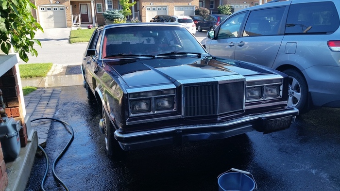

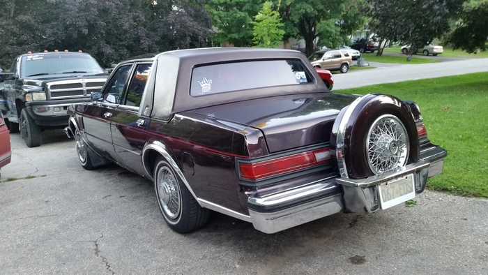

Hey there guys,
I am planning on one day doing a 5.9 magnum engine swap to the 88 Chrysler. I may actually this weekend be picking up a loaded 1998 Jeep Grand Cherokee that I will be using as the donor.. So I will have EVERY single LA and Magnum piece associated with the swap.
From what I can see it looks like I only need the 360 oil pan and an (or both) engine mount(s) to drop this in my M-body in place of my stocker-318. Now I am thinking it would be best to keep the v-belt setup as it has not once in its current 313k km life ever given any issue This would then necessitate the use of the LA timing cover/waterpump and all associated pulley/accessories, which is fine because I have them all anyway.
Hmm, in my reading it seems you need to change out the harmonic dampener on the magnum because it is integral to the pulley. It would seem that using the magnum flex-plate (balanced) that one would not need to use a balanced dampener as the flexplate balances the engine.
