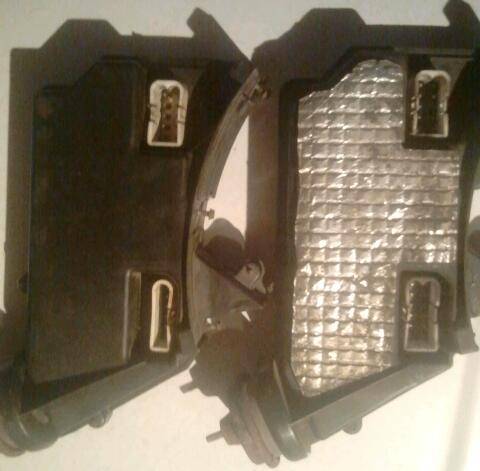

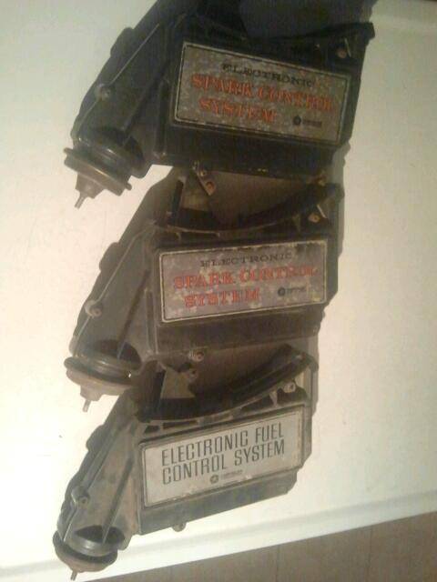

If someone is buying a computer keep in mind they're not all the same.
The top two are the older one's
The bottom I think is mid 80's.
