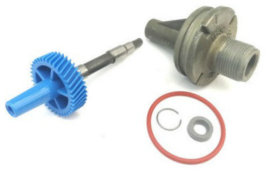

It is not going to be easy to find a all plastic 38 tooth speedometer gear.
It might even be close to impossible.
You might want to convert to the older metal-plastic gear – for a 38 tooth gear used (and repop) are currently and widely available.
I much prefer working with the older speedometer gears/housing setups ('66-77ish for cars or '66-92ish for pickups/vans), for a lot easier to work with, easier to pull the transmission or speedo cable off/on, and so forth.
The only problem with it is you also need to convert to a older speedometer cable – which is a tad more work (but are also widely available).
Unrelated (somewhat) – I have had hundreds of Chrysler speedo gears in my hands over the decades. The highest tooth-count all-plastic gear I have seen, is a 32.
I'm sure they used some 38's (in the early F-bodies) – but I hadn't run across one, yet.
Note this is what I consider an all-plastic gear:
This has the 23 tooth gear.

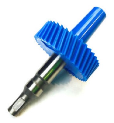

the older plastic/metal gear, 38 tooth (all new parts):
New Mopar OEM Dodge Transmission 38 Tooth Speedometer Gear & 26-45 Housing Set | eBay
This is a 38 tooth short shaft - which you do not want (it is for 4*4 pickups)

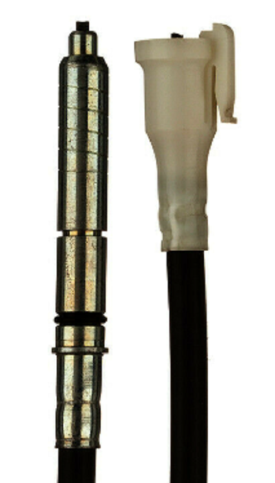

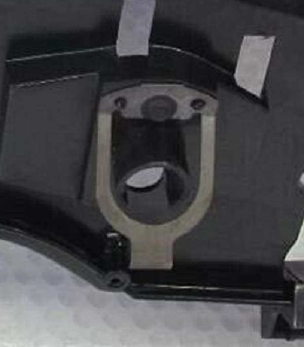

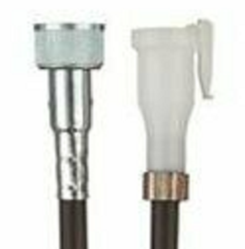

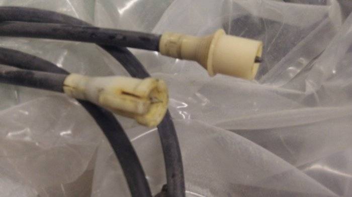

Early vs. non-early F/M-body, which uses a different end at the speedometer head:
Metal clip is top, plastic clip is bottom.
The "speedometer head" ends are the same – just the cable end is different. I “think” all '76-77 F/M's use the metal clip design (clip is on the plastic housing, as shown):
I “think” all other FMJ's used the cable end that has the clip on cable. If you can reach up behind the speedometer head, you can feel either the metal clip (which is pushed towards the head (or driver) to release the cable) or the plastic clip (which is squeezed at the end to release) – you can tell which design end you have by feel.

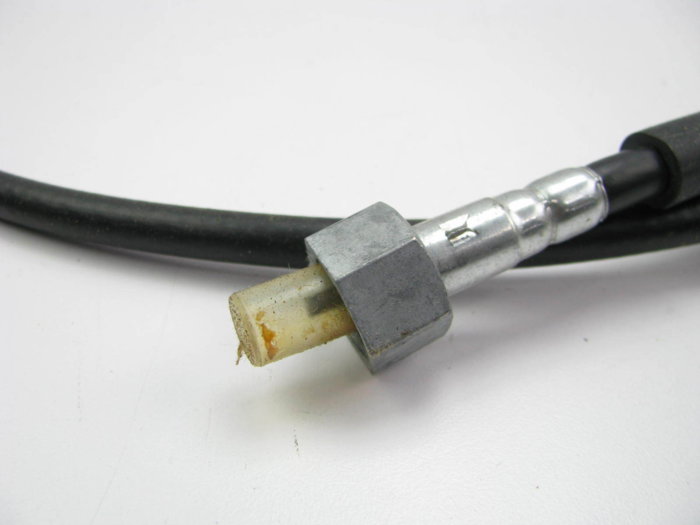

Factory cables have a hex end at cruise servo and/or at metal housing, like this:

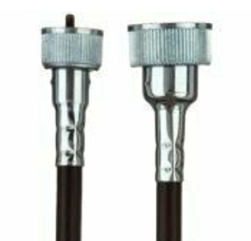

Aftermarket cables typically have a round “nut”. I've used lots of aftermarket cables and haven't had any issues, to date.

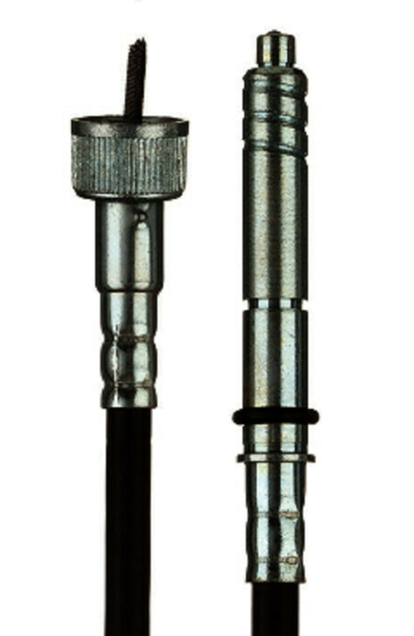

These are four common aftermarket cables, currently being sold today:
AYP-891 or Pioneer CA-3030 (what I think you already have)
AYP-879 or Pioneer CA-3024
AYP-802 or Pioneer CA-3002 (what you want - if you have cruise)
Pioneer CA-3014 or CA-3027 - which is 80". This is what you want if you don't have cruise.
The only ones I don't see made aftermarket is with the early F/M metal clip ends. I still see NOS versions out there – but not hard to convert the more popular plastic clip ends.
To answer your question, if you already have and plan on keeping cruise, you want cable AYP-802 or Pioneer CA-3002.
If you don't have (or want) cruise and you have the more popular plastic clip – then you want cable Pioneer CA-3014 or CA3027.
