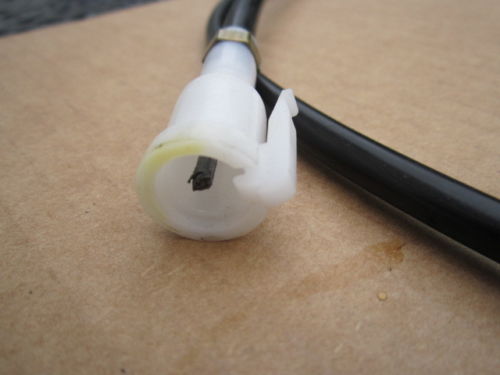

There are two different styles of plastic ends that attach to speedometer head. Yours should have the typical plastic clip on that has been used from ’68 until electric speedometers.

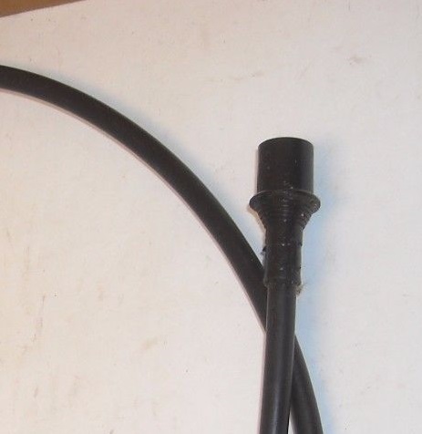

If you have the plastic speedometer gear housing, you will have this end. The only way to remove cable is to remove the entire speedometer gear housing, and remove clips after removal. I do not care much for this design and recommend to replace with the metal housing design (below) when possible.

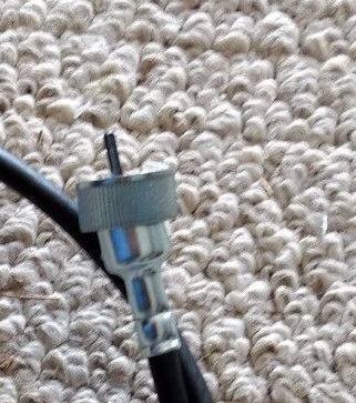

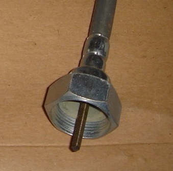

This is the older style speedometer gear housing (all metal). It makes servicing the cable, the transmission and a lot of other repairs a lot easier (and less messy). There is also a lot more part availability for replacement gears, as well. I “think” a 1” end wrench (or channellocks, or whatever you have handy) will remove the nut.

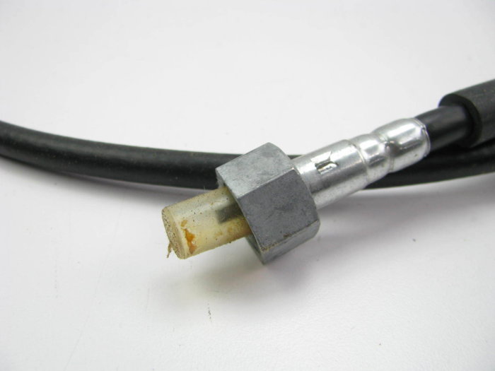

The factory nuts are Hex.
The newer aftermarket ones have round nuts.
I would rather work with a round nut cable than I would a clip on plastic housing cable, on any day.
