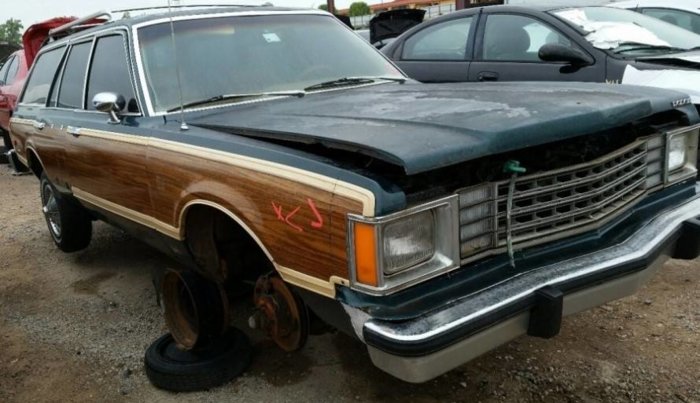

Most F-bodies with bullet mirrors used the chrome versions, like this ’80 Aspen wagon:

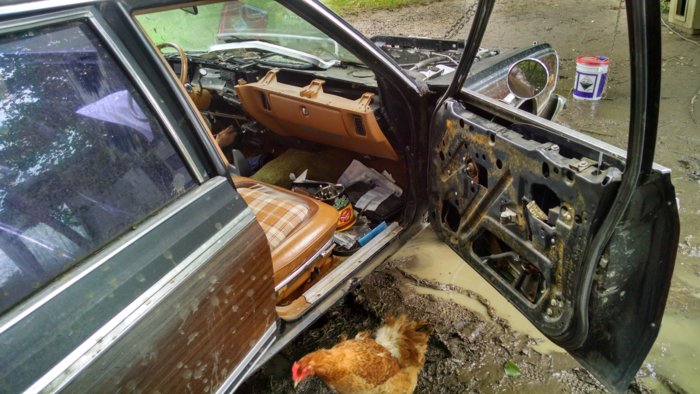

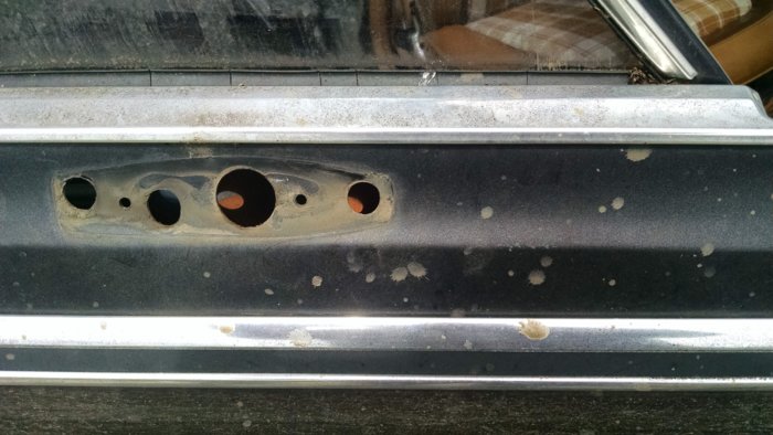

Oh, I remember seeing the pics of that poor dark green '80 wagon. What a shame it was parted out. I was looking for a passenger side chrome (non-sport) remote mirror for OY, and did get one off the black parts Volare in OK that I also got my plaid seats from. I haven't even thought about attempting to mount the mirror yet - cripe I'm still working on the seats! Also, I am somewhat intimidated by the need to drill the holes correctly in the passenger door, and trying to run the cable for such a distance to the dash panel. It surely wasn't easy or fun to remove it from the parts car, and I doubt it would be any easier to mount it again in OY. At least I was able to find one. They seem to be fairly unusual.

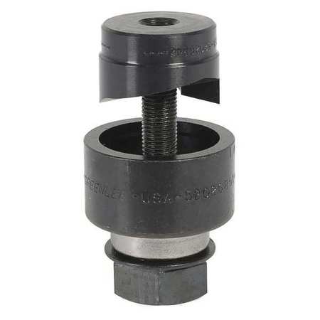

I have drilled a ton of holes in doors - but found later what works great is to mark center of holes, drill a pilot hole slightly smaller than hole-saw center bit or drill hole to use a hole punch set. Later, I found the hole punches are faster, make a lot cleaner hole and works wonderful on non-flat surfaces (like concave or convex door skins). The hole punches also work great for those door edge holes for the cable (on the ones that refuse to easily pop out).
The trick on hole punches is the more expensive ones give very little problems. The cheaper ones give, well, more problems. It comes down to you get what you pay for (but . . . if you might only need to use it once?).
