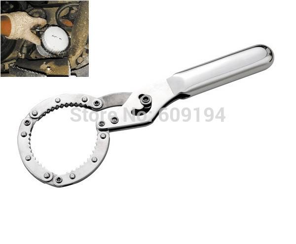

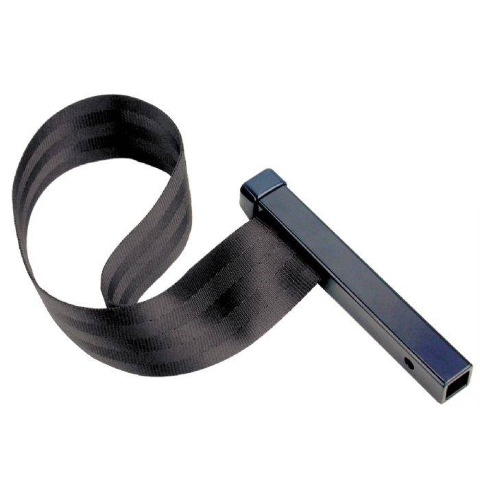

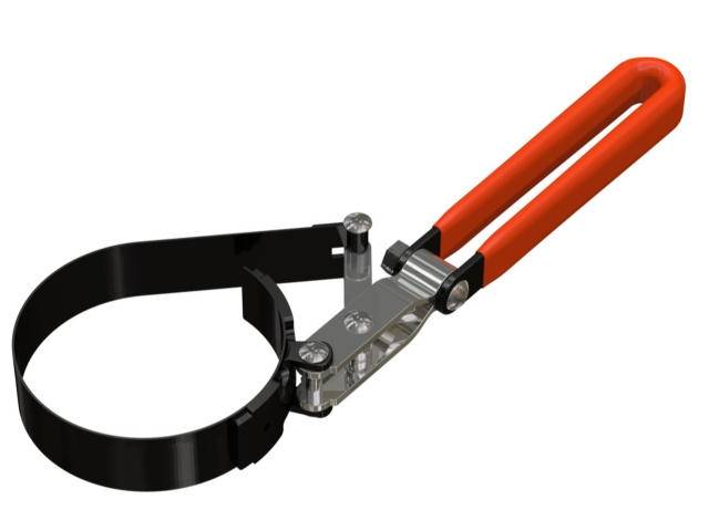

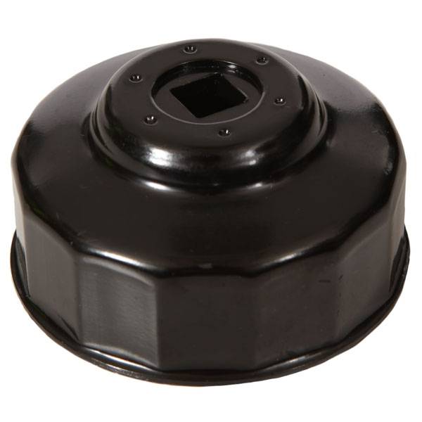

I have a nice selection of oil filter tools.
One item missing is the large nut that goes on the ends of many filters (never needed one – but can see how it would work well).
My two favorites are the seat belt strap one as well as the filter plyers.
The ratcheting strap and the 3 piece jaws can get job done, but not my preference.

Years back I had the band type of wrench and when I was in trouble removing a filter I would run a strip of sandpaper between the band and filter, grit side on filter .. worked everytime .. I've got the multi size one now(last one pictured) and if it slips still I just angle the handle till it grabs, yeah, destroys the filter but doesn't rip the can open .. not often tho I need to angle it..

I have that first one. I originally bought a plastic one......I know.....what was I thinking? Now I have the steel one. Never fails......plus I only do the oil on my cars so I know the last filter was put on right.

Faced with the daunting array of options, I selected something that looks similar to the red handled #4 above only the one we bought is adjustable for the size of the filter.
I HATE IT. I will never buy another one, I will never recommend it. Bleh!
Ultimately, I determined the main issue was with the filter itself. The gasket was heat bonded to the crankcase. Eventually, I partially collapsed the filter with the wrench (unintentionally) and it backed the metal case off the gasket. Used a putty knife to get the gasket off.
