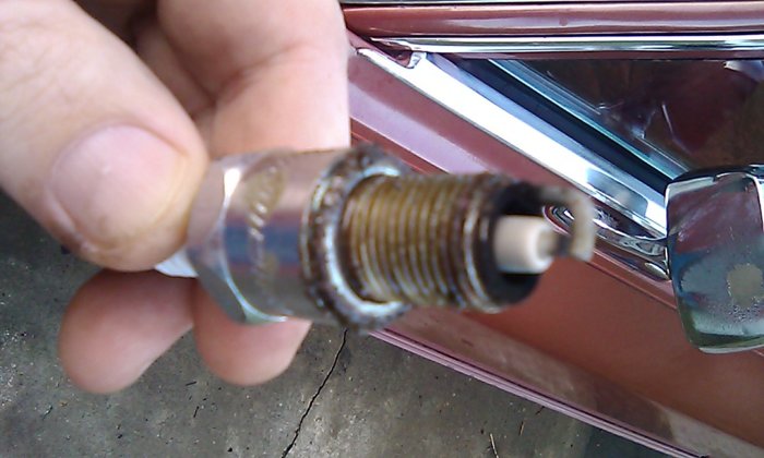

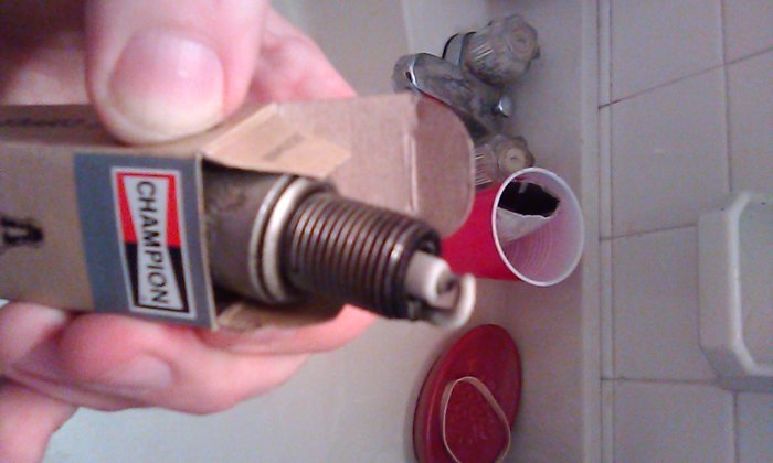

I took one of the spark plugs out a few days ago it looks almost as bad as the old one. old plug is the top picture new plug is the bottom one this is after only 361 miles
1,494
Wow, a no A/C car . . . In Florida.
The spark plug pictures are not the best quality – but do look fine for less than 1k miles.
What are they gapped at?

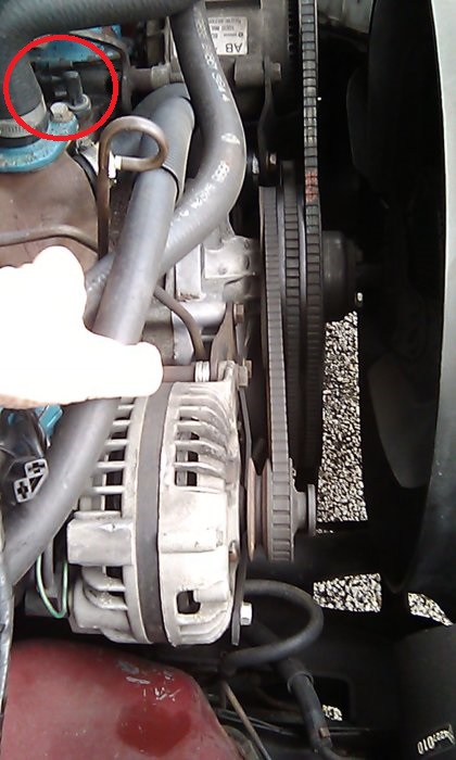

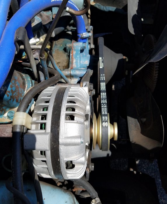

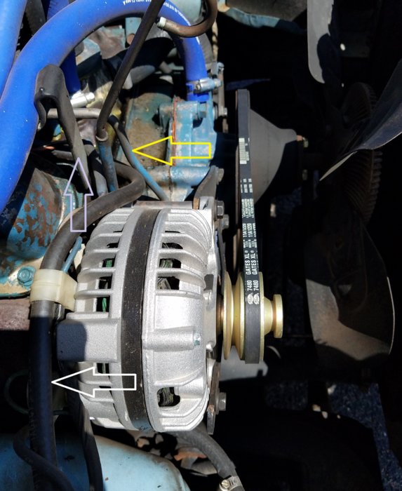

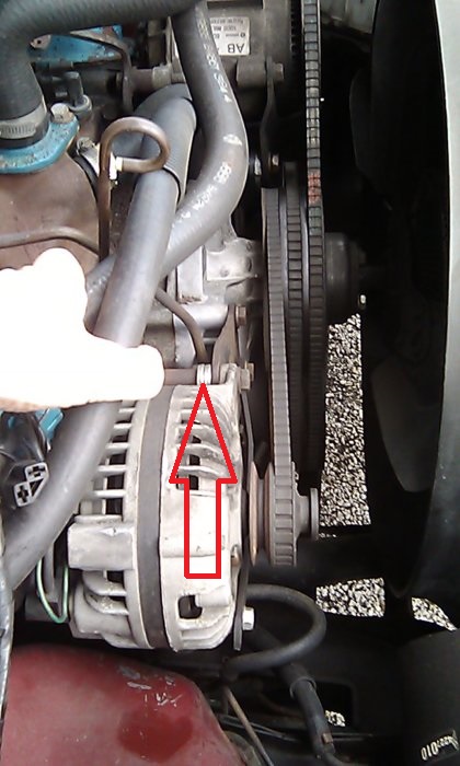

This is a picture of my (mostly stock) factory no A/C ’77 318 wagon. The water pump pulley is different (you have extra pulley to P/S and to A.I.R. pump, whereas my P/S pump goes straight to Crank (a difference in the year made, only).
The drive belt angle is not that bad (seen may far worse).
The only thing I see off is what appears to be spacers on the engine side alternator bracket (red arrow).
There should be a metal spacer and no washers.

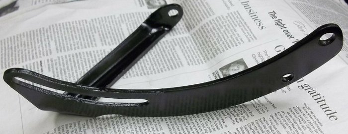

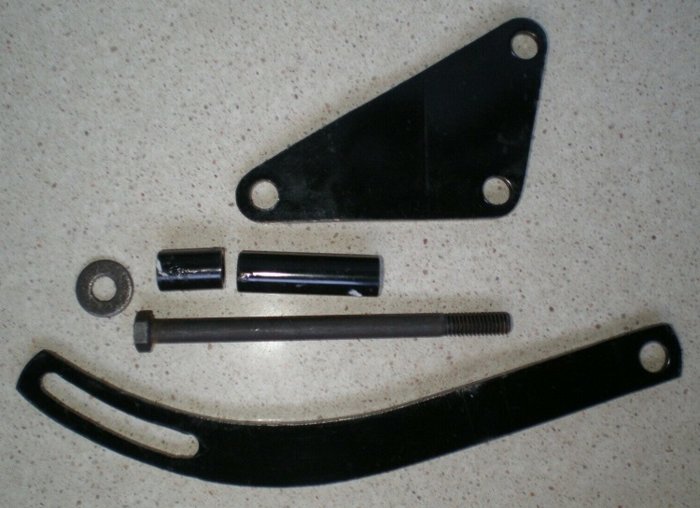

This is a picture of a no A/C alternator bracket setup:
The actual order on the long bolt is:
Flat washer, front-most alternator ear, triangle bracket, long spacer, rear-most alternator ear, short spacer and cylinder head (which is not the order as pictured, above).
When pulling out the bolt, be sure to have fingers on both sides of short spacer or IT WILL FALL. Same on reassembly, insert bolt to where it almost peeks out of the rear alternator bracket. Place the short spacer in and push in the bolt to capture it.
A/C cars have a bit more tension on the bracket, so the adjustable bracket has an extra leg that goes to engine mount for additional strength.
The alternator bracket with A/C, will work for no A/C cars, but not the other way around.
I am curious on what voltage is at the battery terminals when car is running at idle and at say 1500 RPM.

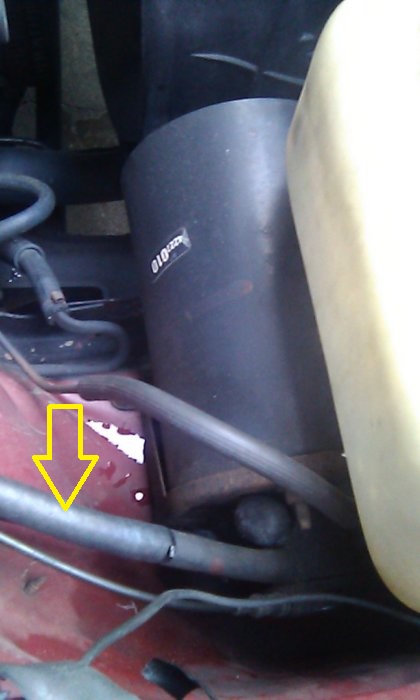

Edit, can you take a picture of your charcoal canister, please?

The spacer your talking about has been MIA since the alternator was replaced in New Haven, notice the shiny new bolt on the lower part of the bracket? Well after moving to Florida they had take the alternator off when they replaced the water pump and found the factory bolt had been stripped along with some other parts

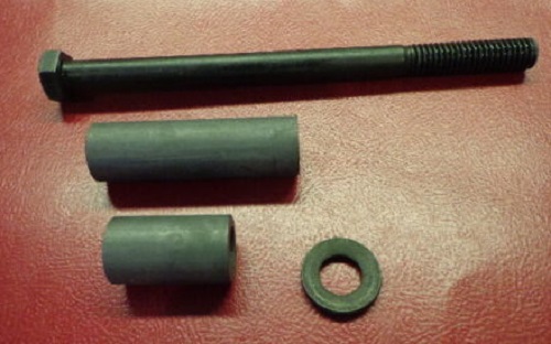

This is what you need to stabilize the alternator and to get belt spacing/alignment correct: 70-78 Mopar A B C E Body Cuda 318 340 360 Alternator OEM Bolt & Spacer Set | eBay .
If you were to get this package, I would shoot a bit of paint over the spacers first. The bolt and washer should be coated but spacers are bare steel.

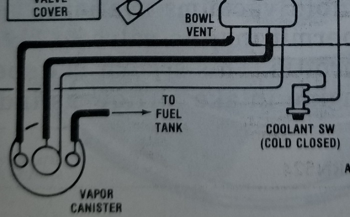

The large hose from charcoal canister (yellow arrow, below). Where does it lead to? Can you take picture(s) of that hose and the other hoses going to the front and rear of carburetor? It will help to disconnect the air cleaner and tilt up when taking pictures (maybe).

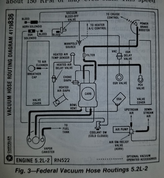

According to my ’86 FSM (Factory Service Manual) and yes I know it is a year newer than your car (I don’t have access to a ’85 FSM). It shows a total of four hoses going to the charcoal canister. Two are vapor hoses (fuel tank and carburetor vapors). The other two are vacuum hoses (one is for a valve).
This is a closeup of the vacuum diagram. The hose size shown is not something to go by. The two smaller vacuum hoses are normal sized. The two larger hoses are mentioned in paragraph above. Of the two smaller hoses, one has engine vacuum when engine is running – which is what is used to purge the fuel vapors from the charcoal canister.
The other hose uses a vacuum temperature switch on intake. It controls a valve on top of (on the side, in your case) of the charcoal canister that stops the vacuum from canister when engine is cold. The other port from the coolant switch goes to the vacuum tree at back of intake. I can see the coolant valve on your intake is currently disconnected (red circle).
Without vacuum from the switch the vacuum hose from carburetor will not suck those fuel vapors from the charcoal canister – so I suspect that canister is full of fuel vapors or stopped up – which is causing your stalling concern (fuel tank can’t vent).
This picture from my ’77 shows the larger fuel vapor hose from carburetor (white arrow, below). The smaller vacuum hose is underneath and is not shown. I think the ’85 vacuum hoses are more towards the center of valve cover before they cross to the inner fender (maybe).

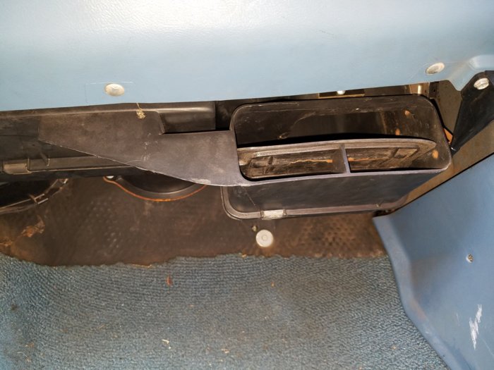

I do love that left air vent (wish the right side had one)
My ’86 has factory A/C. Factory A/C cars do get that Left side underdash outside air vent – which I agree is very nice. The older F/M bodies without factory A/C did get a Right side underdash outside air vent but the newer M/J bodies did not.
The Left side underdash on my '77 Wagon
The right side vent (part of heater case). The knob for it is just off of the picture on Right side.

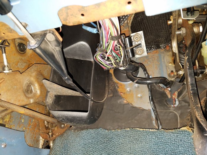

I just picked up a Left underdash vent to install into my ’86 Fifth Ave – because I like it so much. It will require some modifications to the firewall/cowl to make it fit, though.

Car is a factory no a/c car (people have told this car is amazing rare because of it) I just wish it had the right side vent like your wagon does. converting to a/c is temping but not in the budget right now... anyways I do know the charcoal canister was capped off when the carb was rebuilt. I'll still take pictures of everything and next time I have wifi I'll be posting pictures, I'll also be looking in to getting those alternator bolts sometime in the near future
1,494
The no-A/C cars, the heater case and firewall changed in ’80 (I think) and the ’80 and up heater case design also changed (no more right side outside vent) – which is a shame.
You are correct, the newer M-body's without A/C is not that common and rare in the Southern states. My wagon can from up-state New York – so no A/C makes a bit more sense (I guess). Oklahoma is a state where A/C is needed (so what was I thinking when I bought the wagon?).
I will be converting my wagon to the ’80-89 design factory A/C but I also have other chassis modifications to make as well as the firewall (switch out the current 18” wide for wider 26” wide radiator, changing the trunk pan from round ’76-77 trunk pan to wider ’78 and up version (for larger spare tire, more trunk space and to get rid of the ’76-77 hump style fuel tank), to install frame ties and lastly need to modify floorboard for the 5 (or 6) speed manual transmission install).
