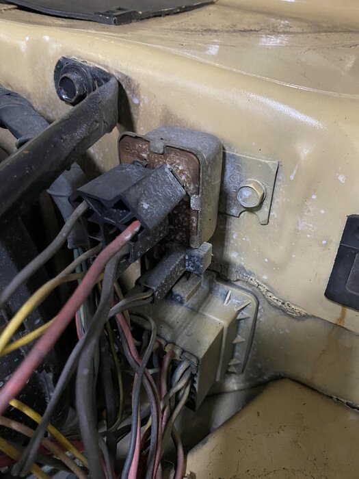

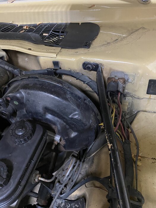

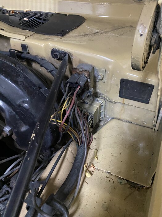

Would you happen to have a picture of the starter relay on the firewall? I didn't realize that my car had one.

Had the same issues with my 77 R/T cleaned all the contacts on the starter relay and had no issues after that.On the firewall next to the master cylinder on the driver’s side you’ll see wires going to a small metal part,that’ll be your starter relay,not a real expensive part if you need to replace it

Yes on firewall beside brake booster. If it's an airbag car it might be a bit different but should still have a starter relay somewhere.

Sorry, my car is at winter storage so I cannot provide any pictures, but thanks to DCAspen for posted some nice ones.
IIRC the wire with the yellow stripe (bottom right on starter relay) is grounded through the neutral safety switch when in neutral/park.
You should be able to check the switch by measuring connectivity between chassis ground and this wire with trans in neutral/park.
The red wire is battery+ and I think the dark wire directly below the red one goes to the starter, should have 12V when ign switch is in start position.
It's possible the wire colours is different on your car, being an '88, but I hope this will help you with your troubleshooting.
