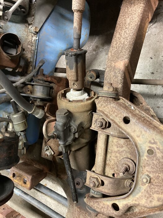

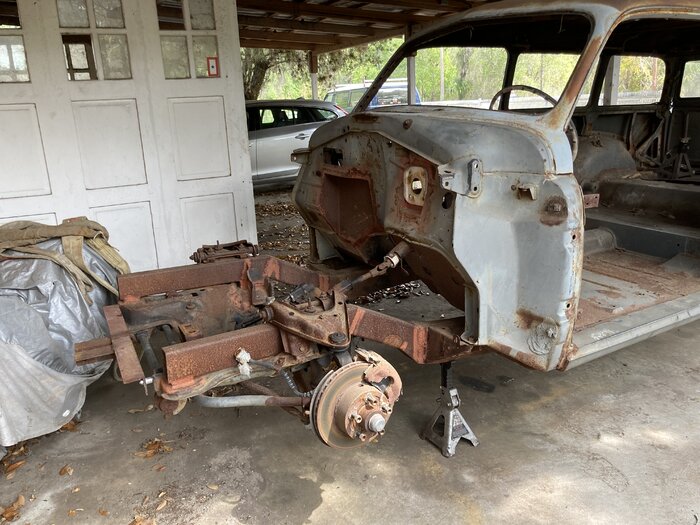

I’ve got a 50 Plymouth Suburban wagon built on a 78 Volare chassis. I want to swap the power steering for manual. Any advice on finding a good used or rebuilt box? Anything else need to be changed to make the swap?
2,992
Luckily, a manual box from any A, B, E or F-body is the same. There was different ratios.
About all you should need is either a manual steering shaft OR a power to manual shaft adapter. Firm Feel has them and possibly some other places as well.

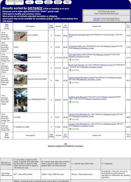

Here's what I found on car-part .com for manual 1978 volare steering boxesScreenshot_20230304-192046_Chrome.jpg
