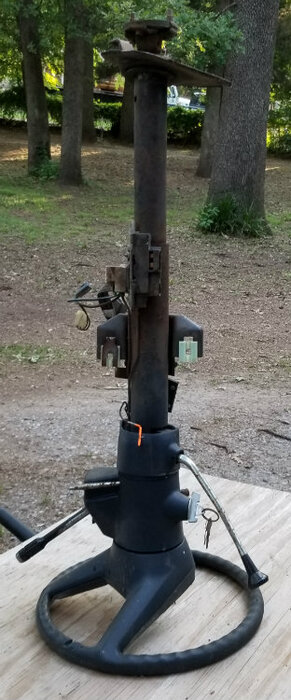

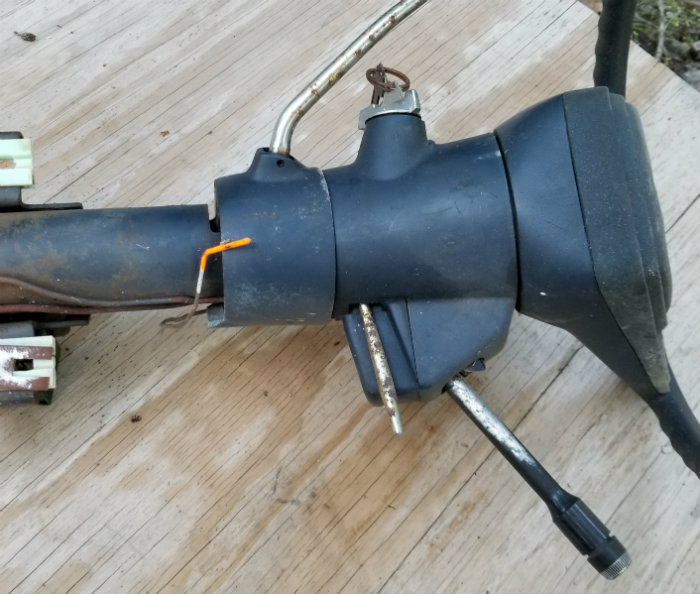

This (tilt) column is from a '84 Gran Fury (M-body)
The upper part of the steering column is the same for ALL Chrysler vehicles from '80 to about '90.

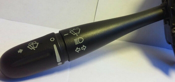

If you find a column and it has a short squared off cap on turn signal switch stalk, then the upper parts will (or should) interchange – including steering wheels.
If the column you find has a rounded off turn signal stalk – then keep walking, there is nothing here for you.

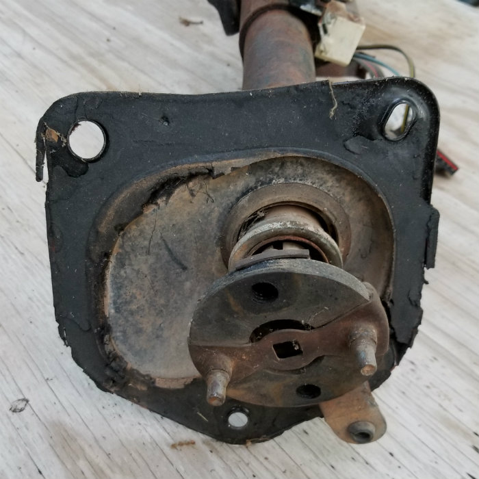

The lower part of column, where it attaches to the floorboard – will ONLY fit FMJ vehicles and the plate is shaped like this:
A person can take another (non J-body columns) and might be able to switch out the lower plate (from an FMJ) and make it fit into your J-body, maybe. That is one thing I hadn't tried to do, yet.
Other lower plate shape/designs are (which are different from each other):

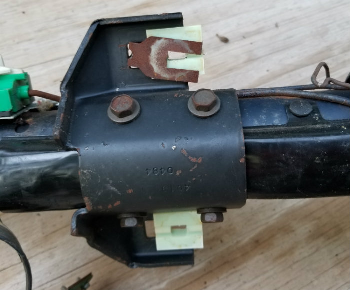

The middle part of the column, more specifically where it bolts to the dash is specific to J-body cars only. The mounting bolts are about 2-3 inches lower than what F/M-body uses (which are about 2-3 inches higher). A person can fabricate a bracket and can make almost anything fit – but just letting you know what the differences are.

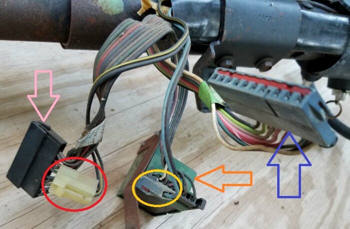

The last part has to do with the wiring harness connectors. This column example is from a '84 Gran Fury (M-body). It has five different electrical connectors – which are different from your '81. For what ever reason, Chrysler liked to change the wiring connectors about every two (or so) years.
Most things electrical can be carried over, if needed.
