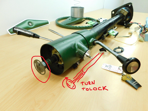

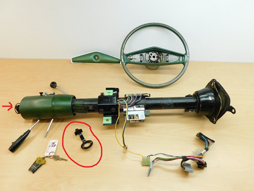

If anyone runs across a 78-81 (maybe to 89) saginal Tilt/Telescopic column, I'm seeking a few misc parts. The lever to lock the telescopic, and the pin in the core that locks it.
the two circled parts.
