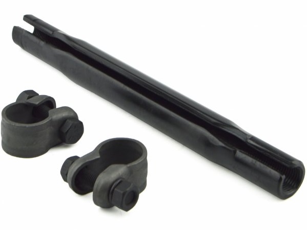

    As mentioned above, the big issue is the split adjusting sleeve. They deflect (a lot) under hard driving – and going with solid tie rod sleeves helps tons – for those who plan on hitting turns hard. Those split adjusting sleeves work good for about 90% of people, but those who drive hard - they are like soft rubber tie rods instead of steel.
    This is a picture of a normal split tube adjusting sleeve

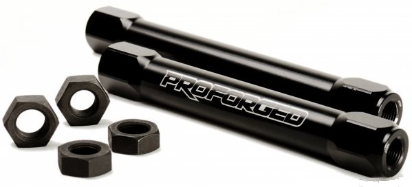

    This is one example of a solid sleeve (there are others, as well).
    Back in the day, if a person was driving a car over rough roads or potholes constantly, we would recommend replacing tie rods with 11/16” versions. That said, I don’t know of anyone today who would subject their FMJ to driving on rough roads or potholes, so a non-issue today.
    Also, those who live in rust prong areas – the solid tubes keep things less rusty.
    For those who are road racing or just drives car hard (ie: I fit that bill), the solid sleeves are well worth the money.
    Sense I drive cars hard and plan on some road racing (with big blocks), the solid sleeves and 11/16” tie rods are the only way to go. The other 90-95% of our members, using 9/16” rods and split sleeves will be fine.
