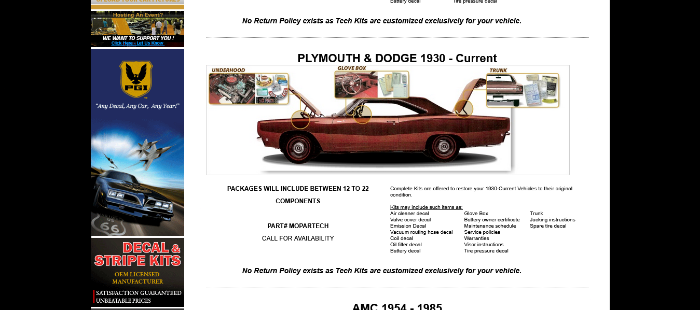

Now to another and more interesting things from Grumpy Old me:

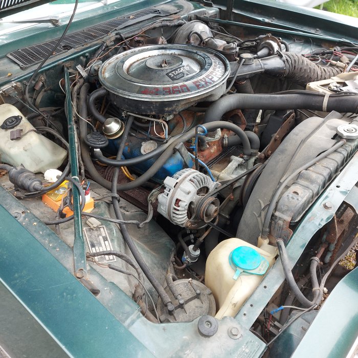

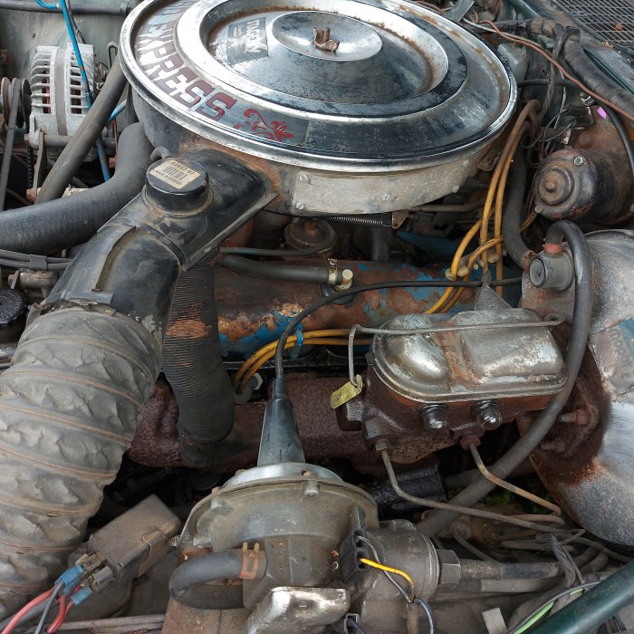

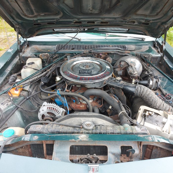

All G22 had stickers of various forms informing the owner about: The wacum lines under the engine hood (Mine is in perfect nick so I do not need that)
In the rear luggage compartment there is a sticker showing how to use the jack in case you have got a flat tyre or want to swap for winter tyres. It is an
instruction of how to do the job and do it safely. Mine is not in good shape and hard to read as time takes its toll. On the front of the car (forward of radiator)
there is a small sticker I cannot read but probably some of you would know? And another regarding cooling. That one is gone completerly

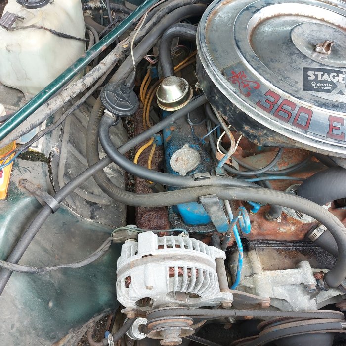

On the air filter there is antother large one as per attached photo. 360 Express and a black one Direct connection. This can be reprouced locally over here
I presume; in fact all I believe. Having said that it would be easier if one of our members may have them for sale.

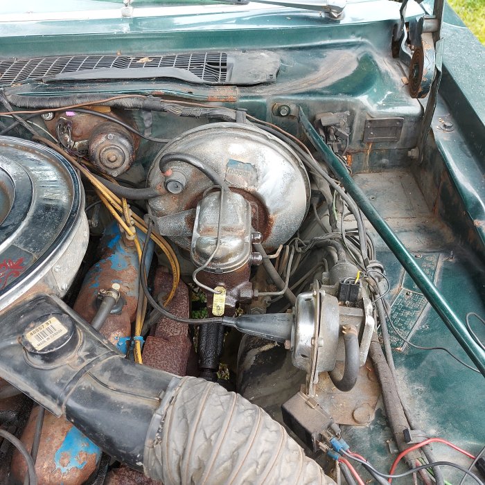

Another one is on the wacum box as per attached photo.
Any photo will do and the measurement of the stickers (L x W x H) please.

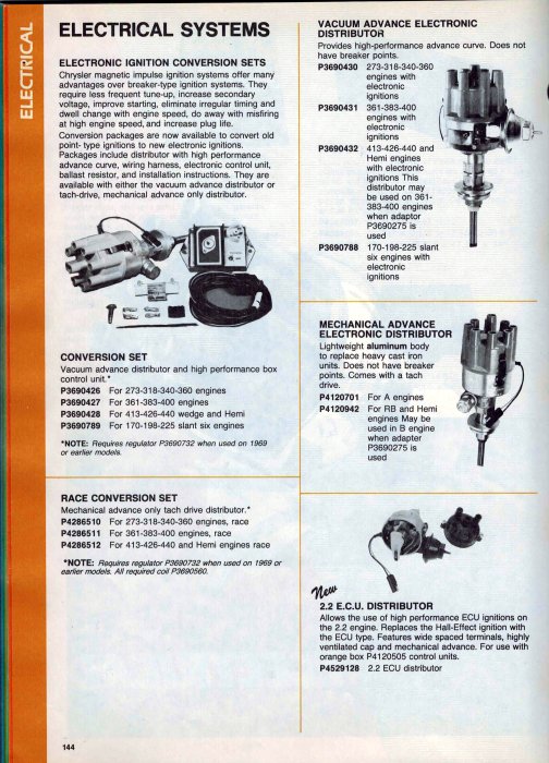

Thanks a lot for your information. It was like that when I got her. The Lean Burn I tossed away as that packed in after a few years.
The norwegian importer did not know how to repair it so I bought the Electronic Ignition instead. Blinded off the aircleaner on the right side where the Lean Burn was.
It let's your ignition ignite. At the time set but the computer with many additional inputs, e.g. 'idle throttle stop', water temp, manifold pressure etc.
Most of those stickers aren't reproduced, nor enough market for m body stuff.
The lil red express one like AMC said is exactly what its from. Originally there wasn't anything on the air cleaner. Not sure if the first couple years of F body had the lean burn pie tin like C bodies had but Ms never had that. Older mopars had engine stickers like 360 4 barrel on it.
