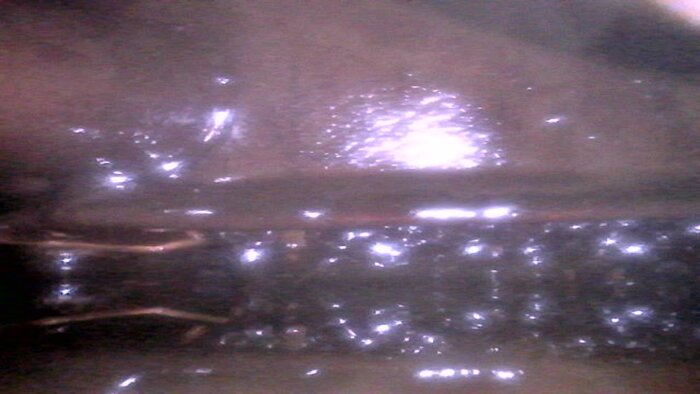

Hard to make it out but I used a bore scope through the oil drain hole… I believe the SeaFoam and good temperature loosened some funky sludge.

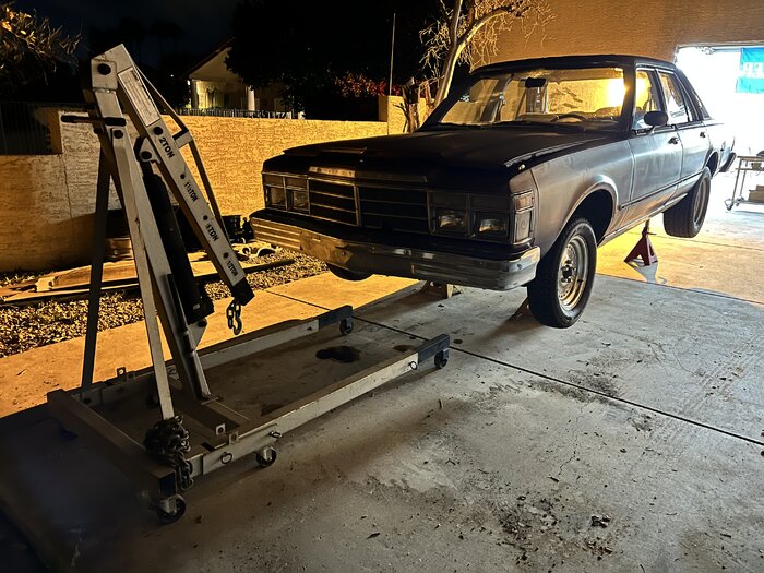

I guess that’s about what I thought, it’s been a long time since I pulled a pan with the engine in the car.
I cant Get the oil pump drive gear out because of buildup on the bottom of the shaft I’m assuming and don’t have a tool that can get under and twist and the long nose Vice grips won’t hold tight enough to twist end pull. ☹️
I’ll bite the bullet and raise the engine and just put in a new pump.
Hopefully the trans can stay in place and the rear main can be changed.

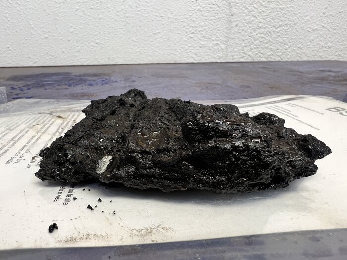

I did figure it out. Clogged F’ing FULL of Carbon!!
So I dove in head first… Steam cleaned the entire underside and under hood then;
I pulled the intake and valve covers, removed the exhaust, and cleaned/flushed (diesel fuel and Marvels Mystery) engine top to bottom, rotating, scraping And scrubbing anything I could get to.
I removed and replaced the oil pump with a Sealed Power High Volume Pump from RockAuto, new pan gasket and reinstalled everything.

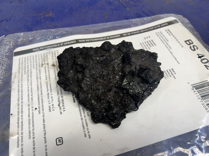

Pulled brand new Sealed Power HV pump off (yes, I bench primed the pump and it was pretty tight when turning ) , walked to bench put it in the Vice and tried to turn it, locked up!!!
I pulled the top plate off the pump and it had a bunch of little dimples on the face of the cap. Put it back together and it would spin about a half turn and stop!

So lesson learned, buy a good oil pump… Especially when it’s inside the F’ing Pan!!!
I’m my defense, I have always bought Melling pumps, never had a bad one but I’m on a thin budget with Lebron so I tried this super cheap Sealed Power pump-
On another forum a few people stated that Sealed Power oil pumps are made by Melling… Don’t believe the Hype!!!
