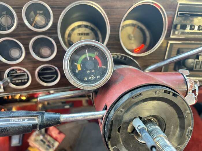

IT HAS GREAT OIL PRESSURE!!!

Great oil pressure for this old girl named Lebron!!

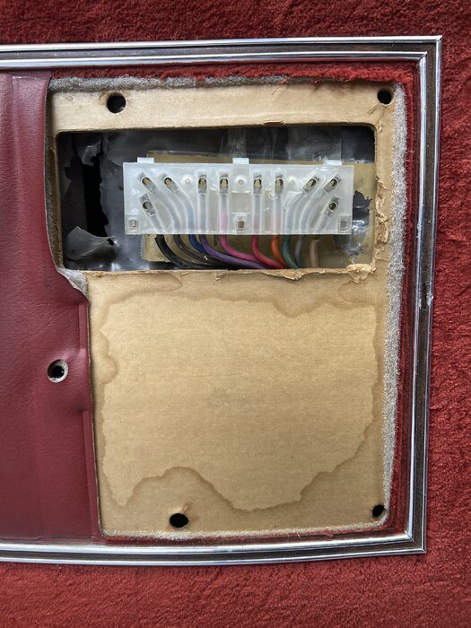

The windows will be a huge undertaking but so far there is 12 volts at the switches (or where it’s missing switches!)

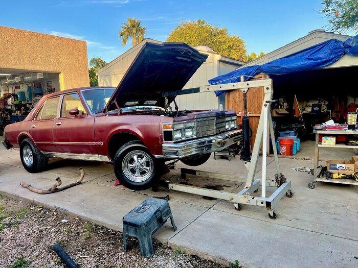

So since everything seems good… Back in the air to once again replace the oil pan gasket!!
This time I had it out in about an hour, getting this job down!
It’s a blessing in disguise really, the oil looked pretty clean coming out but when I got the pan down there was quite a bit of sludge and carbon that had collected and didn’t drain out.

I wanted to thank @Justwondering for the excellent help with pictures of the factory 1979 service manual!!
All of the pictures sent turned out great and were an invaluable resource!
They are still being used as I tackle the Power Windows!!!
