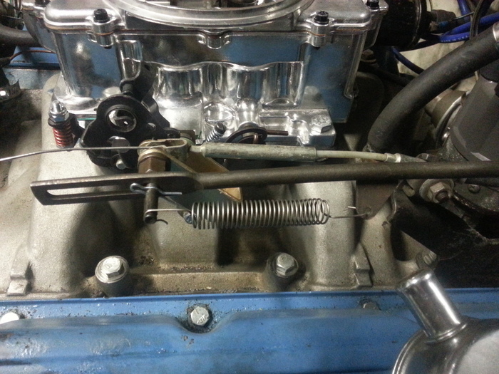

I have a 87 fifth avenue with a edelbrock performer intake and the stock accelerator cable kick down cable and cruise cable. I was wondering if anyone has any advice on hooking up all the cables on to the summit carb which is pretty much a Holley prior to this I already had done the lean burn conversion and I still have all the original pieces off the 2 barrel.

I've got it..it's pretty basic to set up. You do need the mopar adapter. The manual has simple instructions for hooking everything it up..also comes with a disc
I'm running the factory linkage. However, if you're going from 2bbl to 4bbl, you'll need different stuff anyway. I already had a 4bbl, so I didn't need to worry about it
I bought the longer diplomat cop car throttle cable but it seems just a bit to short still and it seems crooked do I need a longer cable from a different car
Yeah, the servo quit working and I don't really have any plans for keeping it anyway. But it would just hook up like normal
