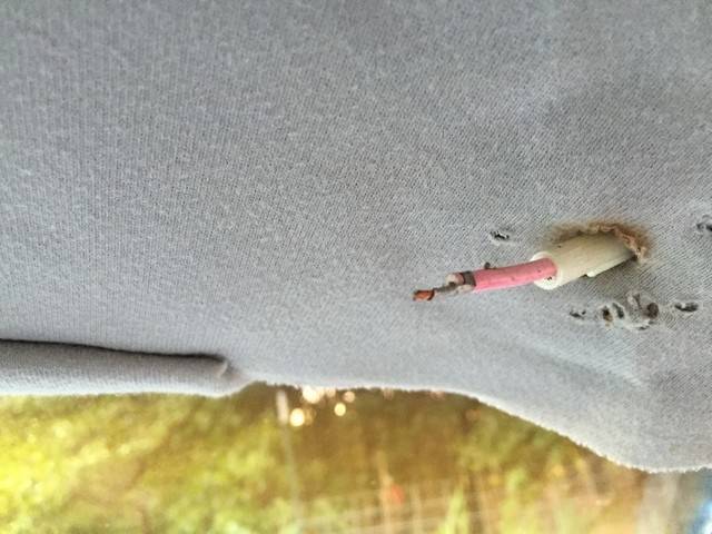

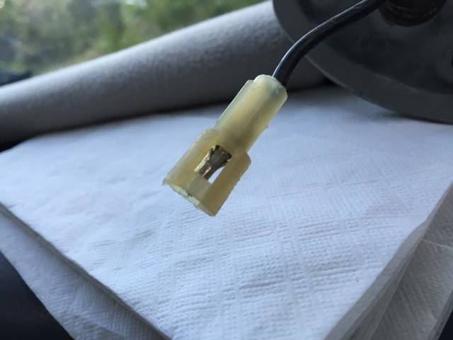

If you have a volt meter, check for power at the wiring connector (I think the wire is pink but could be wrong). It should be 12 volts all of the time.
If not, check the fuse. If that connector touches the frame, it will pop the fuse right away.
You have to pop that connector in quite a distance, as well.
