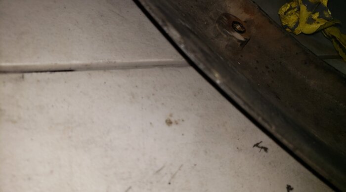

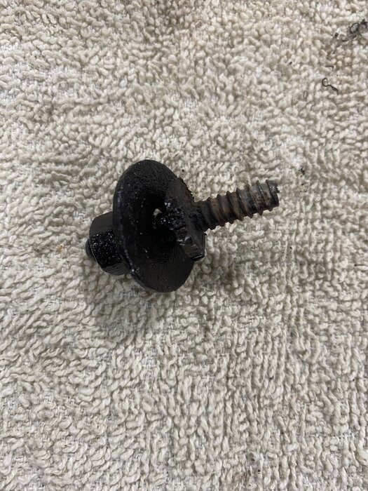

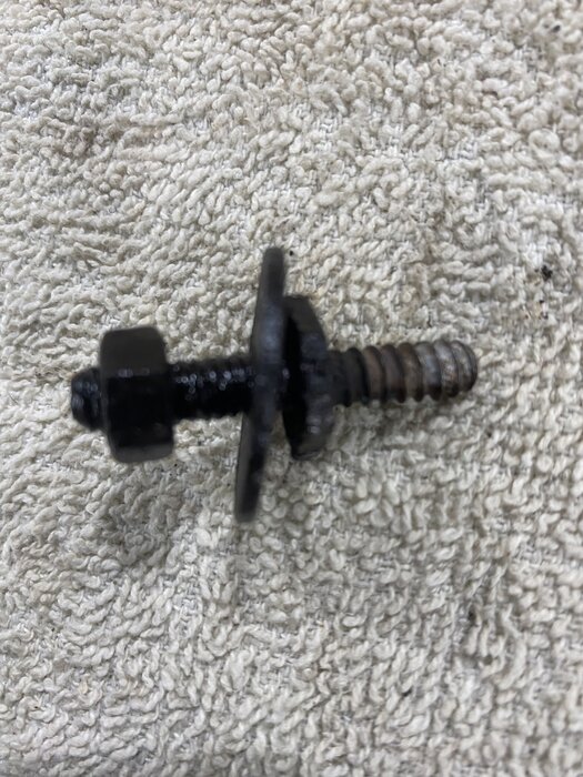

Apr 17, 2022 #1 3 383scuda Well-Known Member Joined Dec 5, 2021 Messages 52 Reaction score 16 Location Smithville, MO I know I've seen these somewhere. I need to get some of these studs for my Super Coupe flares. Can anyone help?

Apr 18, 2022 #2 V volare 1977 Well-Known Member Joined Jun 12, 2014 Messages 1,930 Reaction score 305 Location maryland They look like studs they used on hood scoops. Should be repops out there.
Apr 18, 2022 #3 V volare 1977 Well-Known Member Joined Jun 12, 2014 Messages 1,930 Reaction score 305 Location maryland these ford ones look close Mounting Stud - Hood Scoop - EACH - Repro ~ 1968 - 1972 Mercury Cougar - 1968 - 1972 Ford Mustang
Apr 18, 2022 #4 BudW Moderator Staff member Joined Mar 4, 2012 Messages 5,124 Reaction score 1,494 Location Oklahoma City It would be nice if the link, above, would have measurements on it. It might work, then again . . .
Apr 18, 2022 #5 Oldiron440 Well-Known Member Joined Apr 25, 2017 Messages 3,172 Reaction score 818 Location Iowa I’m needing those as well for my Ford project…

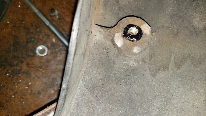

Apr 18, 2022 #6 george cobb Active Member Joined Mar 28, 2020 Messages 42 Reaction score 97 Location ohio the holes in my flairs were so bad I drilled them out to 3/8 and glued in 1/4 20 rivnuts

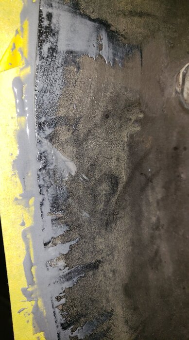

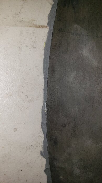

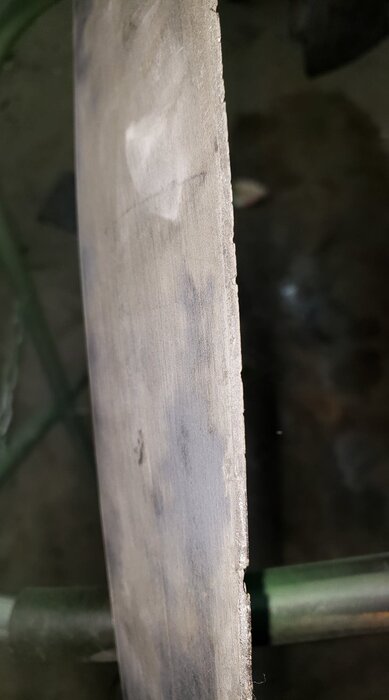

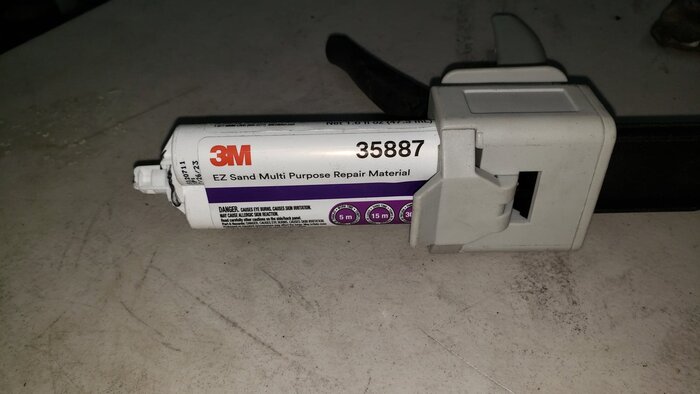

Apr 18, 2022 #7 george cobb Active Member Joined Mar 28, 2020 Messages 42 Reaction score 97 Location ohio also this material is great for filling in any damaged areas the darker gray in the one picture is the material after the tap was remove. you can sand it down and it closes off the damage area at the top of the flairs
