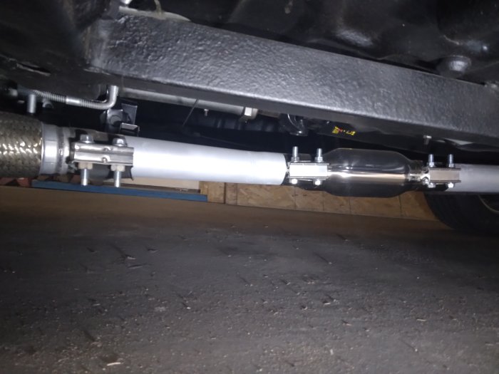

A flex pipe before the frame clamp would work good. They're available in various sizes and lengths. Summit has them, and most parts stores have a selection.
You can see part of one on my car in the left side of the photo.
