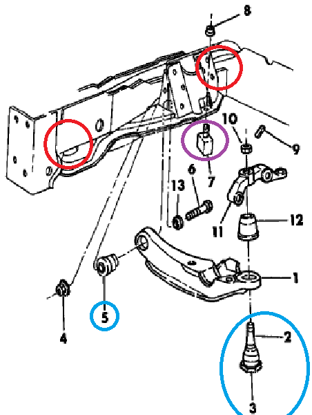

Parts that normally wear out are:
Lower Control Arm:
Lower Ball Joint and Control Arm Bushing are items that normally wear out (blue circles).
Lower Control Arm rubber stop (purple circle) - which are sometimes missing or broken. If broken or missing, you will have metal on metal after hitting a large bump in the road. If intact, no need to replace.
K-frame to frame rubber bushings (more about this later).

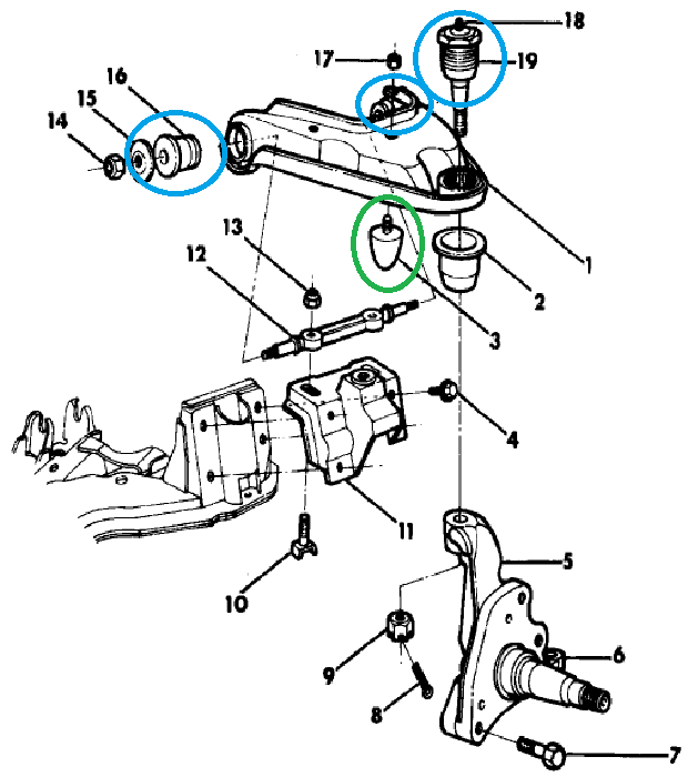

Upper Control Arm:
Blue circles are the same as top picture. These items to normally wear out on cars life.
Upper Control Arm rubber stop - sometimes this is broken or missing. If intact, leave alone.

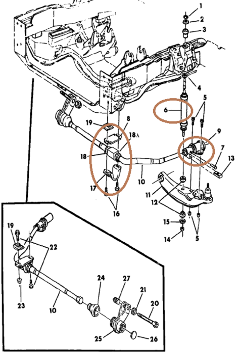

Torsion Bars:
Shocks do wear out - and is the most common thing to wear (on any car). I would replace these before anything else.
Torsion Bar Bushings (brown circles) at K-frame or at Lower Control Arm. These items do give some people problems but most of us, those bushings are usually good. The bad news is if your torsion bar bushings are bad, there are none available (from Chrysler or aftermarket). More about torsion bars below.

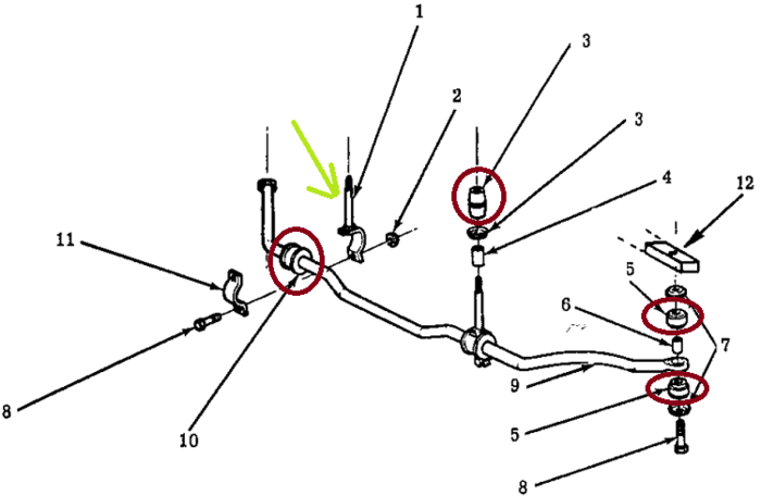

Sway Bar:
Here Urethane (or Polyurethane) makes a HUGE difference on how car handles over rubber. Unless there are no options, I will NOT use rubber for sway bars (as opposed to control arm bushings, where I WILL NOT use urethane). Bushings for item # 3 and 5 are almost universal parts.
The sway bar frame bushings (item # 10) are more specialized - but can be located. The trick with middle bar bushings is to measure the diameter of bar and the outside diameter to get good replacements. Also, one will need to cut the middle bushings to get them to fit.
Also, links (item #1) have a tendency to break sometimes.

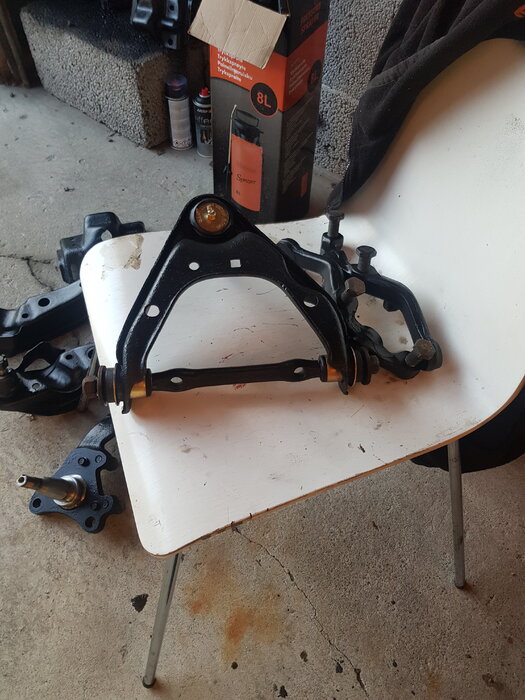

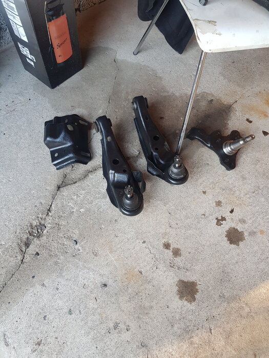

I replaced all the parts Bud mentioned in his post above. Off course I forgot to take pictures along the way.
I went all rubber except the K-mounts and torsion bar bushings.
The only special tool i bought for the job was the upper ball joint socket and a Miller alignment tool:
Proforged Chassis Parts 124-10001 Proforged Dodge A/B/E-Body Ball Joint Removal Tools | Summit Racing
Remember too loosen the upper ball joint with the control arm still attached to the car
But I do have access to a hydraulic press at work, you will need one for dismantling the control arm bushings and the torsion end bushing piece from the bar. The torsion end was the thing I struggled the most getting off. First the rivet had to come out, and then the end piece was rusted solid to the torsion bar.
The rest wasn't too bad, but prepare to fab up some creative solutions for getting the UCA bushings out. IIRC some big square washers and a bench wise was used in combination with foul language and a sixpack for thinking clearer...
But there is a tool for the job out there as Mirada 80 mentioned.
The handling on my Aspen improved more than I could dream of. I did it all in one operation so I cannot pinpoint what did the greatest difference. But I did modify the slots on the UCA-bracket some to get more positive (+4.5 degrees) caster on it. Also adjusted camber to about -0.5 degrees.
I suspect that and the poly K-frame pucks did a lot to improve the handling.
There are some threads on this forum with pictures and explanations. They sure did help me a lot.
Thank you @Sub03. Those upper ball joints (if needing to be replaced, that is, do need to be removed and re-installed with upper control arm(s) still attached to the car. A lot of torque is needed to replace them and having a car fixed in place helps many-times fold. If trying to remove or replace with control arm in a bench vice, the whole bench will rotate or turn over.
I like your paint job! The only thing I might recommend doing additional might be to put some clear paint on the bushings and/or ball joint tops, to prevent rust and more so, to aid with cleaning.
I like it, too. Thanks for the camber tool hint. I did a full front axle Job on my Dodge MB400 - essentially exact the same setup as with the M-Bodys except the 4000lbs axle has coil springs.
Before putting it all together again my UCA and LCA looked the same. Then came my "abilities" and on are the scratches. :D
