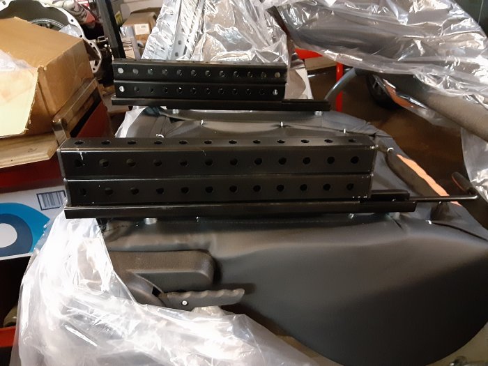

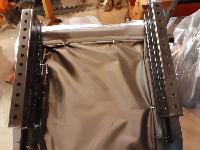

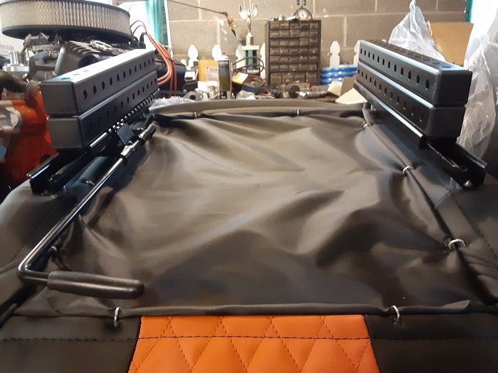

Okay gentlemen , as promised here's the solution. 1&1/4 box tubing available at "Home Depot" , 1&1/4 square furniture leg finishers available at any hardware store as well as plain old 5/16 " nuts and bolts to hold it all together. 1 bracket stacked for the passenger side to allow for the floor hump and 2 stacked brackets to correct for seat height on the drivers side seat. Thankyou all for your advice !!

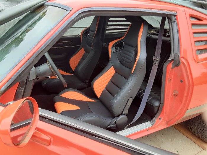

Got them on E bay. Shipped from DNA Motoring I believe somewhere in California. $277.00 -w-free shipping. Wuhoo!!!! Came out nice and again , thank you !
