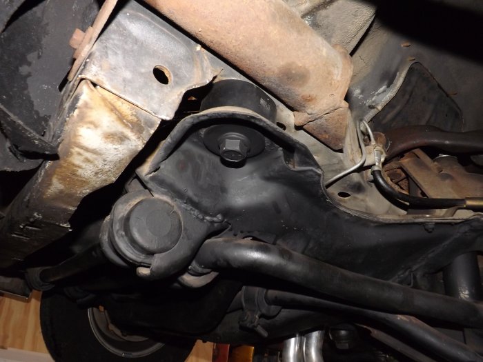

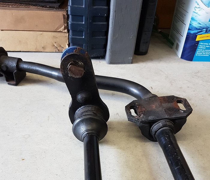

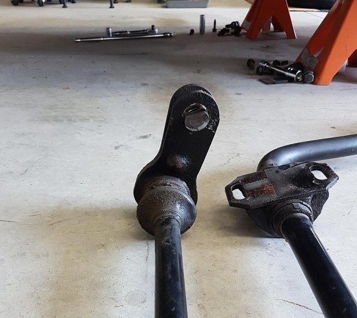

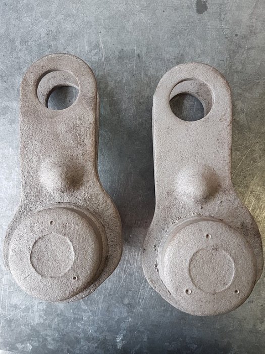

So here is the weird thing: the t-bar hex end anchors have a visible assymetric shape to the anchor "ears" that the adjuster bolt itself hooks into (see 1st pic).
It would appear that one side is pretty flat, while the other side has a rounded cut-out, the implication here being (my thinking): it is probably intended to avoid some kind of interference during the install.
Having said that, because of how these actually mount on the t-bars it would appear that regardless of which anchor I put on which bar, the end result is always the same (see additional pics).
