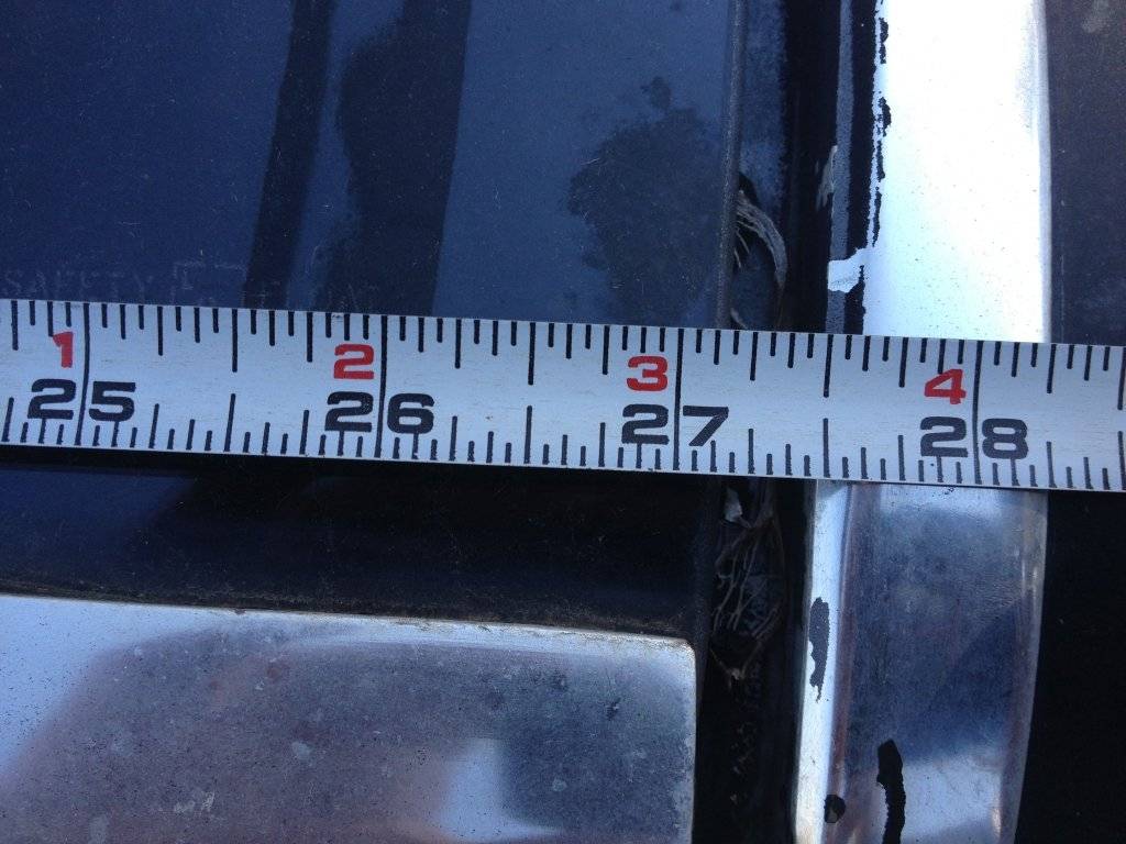

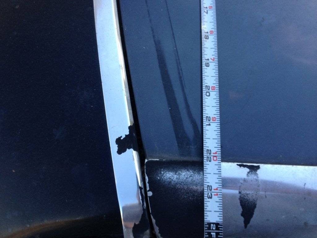

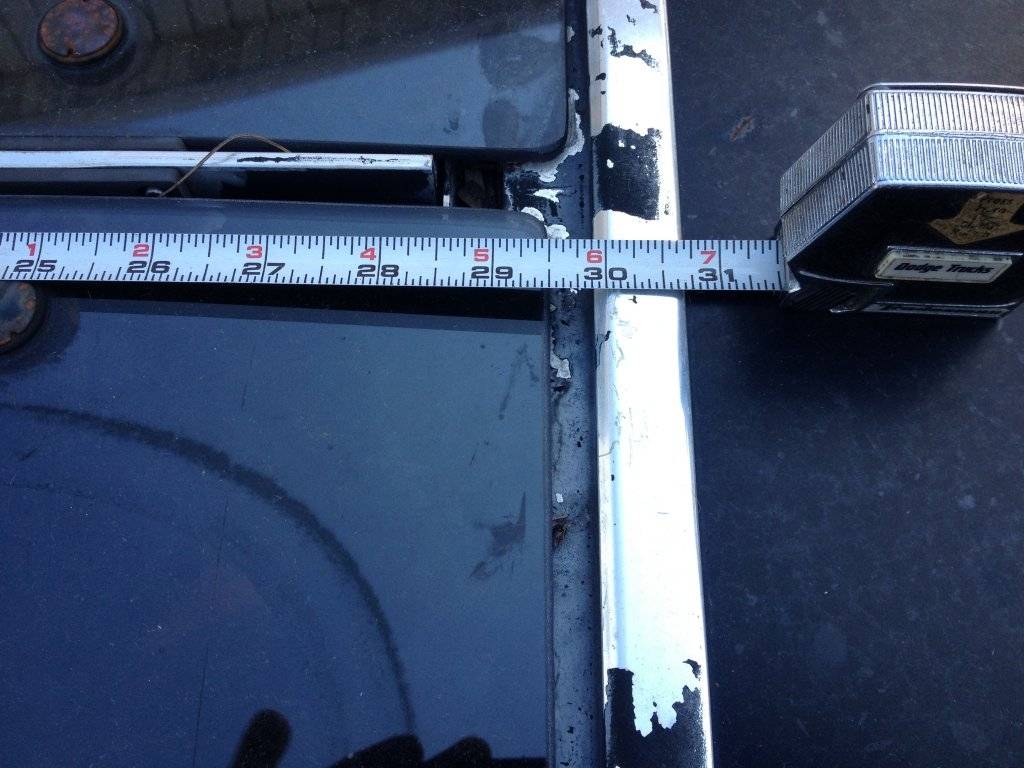

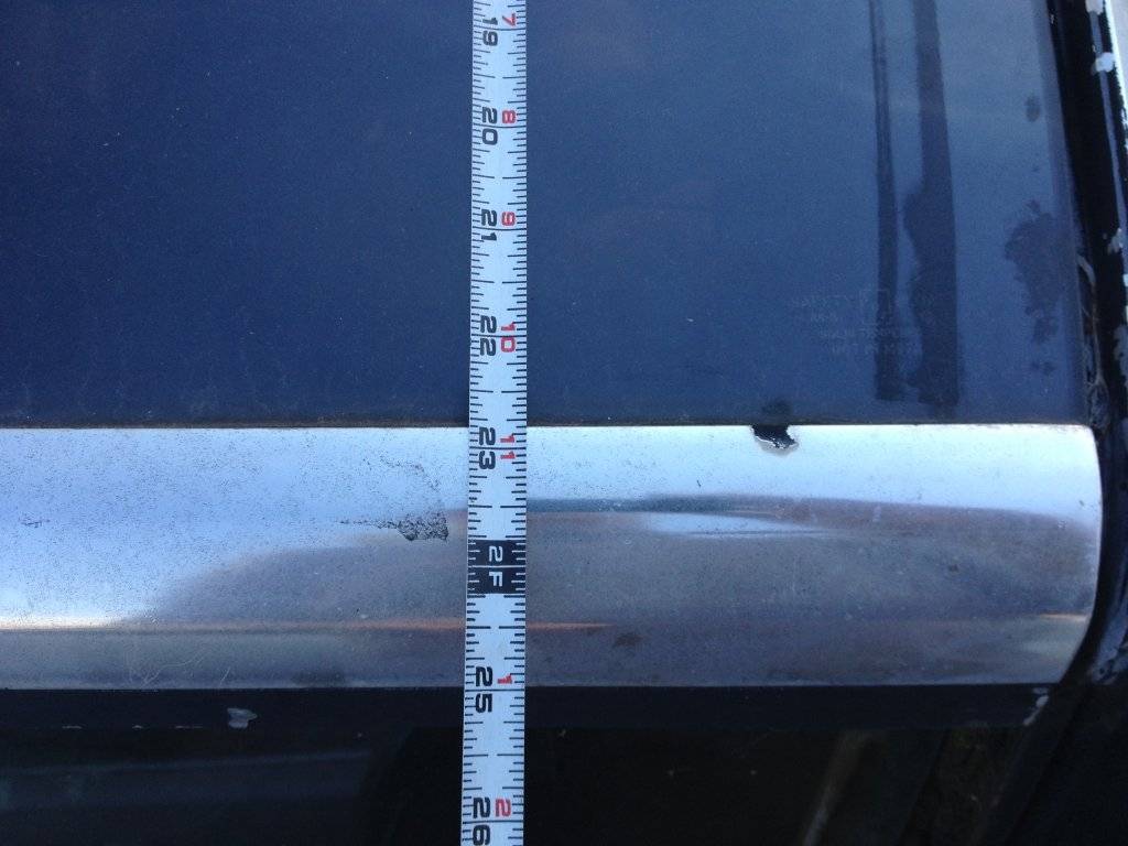

I have a 79 RT with t tops. I will get some measurements and pictures for you as soon as I can. What are you needing, the measurements of the glass panels?
droptop
Jan 12, 2012
289
148
These measurements are for the driver side t top on a 79 Aspen R/T
Image 2399 is front to back in the center. That is 29.5"
Image 2400 is front to back on the outside. That is 27.25"
Image 2402 is side to side at the center of the front locating pin. That is 22.25"
Image 2403 is side to side at the center of the back locating pin. That is 22.75"
