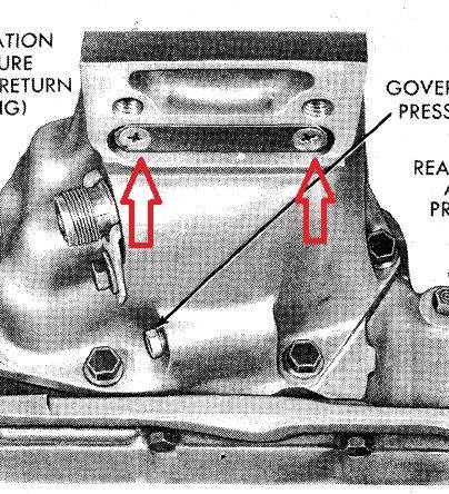

So, I'm in the middle of a trans rebuild right now on a 904, I just got to the tailshaft and I'm trying to get the 2 screws that hold the plate that covers the snap ring out and they will not budge!!!
I haven't been trying super hard since I don't want to strip them... Does anyone have any advice to help get them out? Thanks.

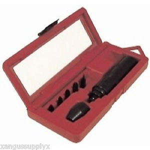

one of those hammer driven hand impact tools.
For those Phillip head screws, I don’t recommend heat.
That cork gasket wet with ATF sounds like a visit from your local fire dept. will be coming soon.
The impact screwdriver pictured in post # 3 is the ticket.
Just hold the handle in direction you want screw to spin in, tap it with a hammer (not hard) and they will be out in no time.
