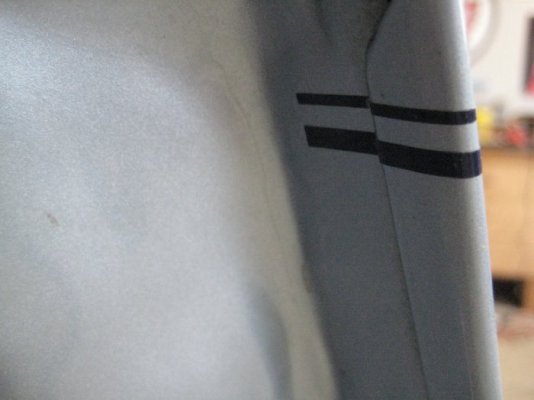

Start laying the pin stripe by gently tapping one finger to set it in place every 6" (15cm), or so, checking straightness every time. Don't stretch the pin stripe, but keep it taught as you lay it on the body pulling the backing off as you go along. By tapping every 6" (15cm), you can adjust it as required before the final firm passes. Leave about 1/2" (~13mm), of extra tape at each door gap to allow you to wrap around the edge of the door or door jam (picture below). When you are happy with the stripe you have just added, gently slide your finger along the strip, check straightness again then a second time to set it in place. Now grab a rag or shop towel and do a third pass with firm pressure. Wrap the end of the strip around the door edge or gap (this needs to be clean too). Grab some clear nail polish or clear lacquer and a small paint brush to put a small dab on each end of tape, this will prevent the tape end from coming loose.
