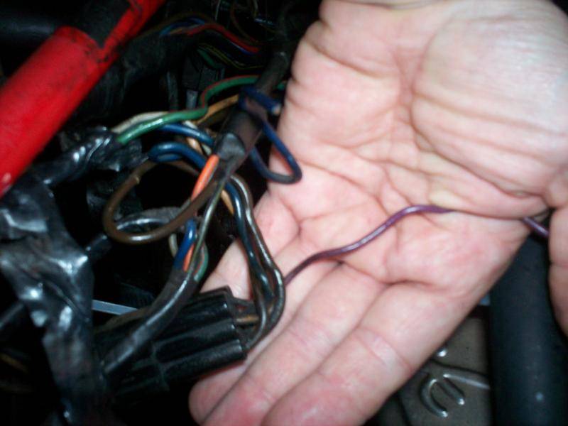

    I think I have it, but am not sure . The goober cut the wire and used a thousand feet of black electrical tape to hide the sins. I have a 6 gang connector on the passenger side with a cut purple wire. I think the purple wire is my temp sender wire, Can anyone confirm this purple wire? The rubber 90° boot is cut off, other wise it would be obvious. 100_3289.jpg
    There is also a beige wire that is cut off too. The purple wire is on No6 terminal of the connector and the beige is on terminal 4. It could be either wire. Any help, thanks.

    The temp wire is usually purple/violet, if that helps any.

    yep. At this point everyone is going on the purple. thanks all

    Slant6Billy what was your remedy to the 90 degree elbow plug cut off? I just had mine snap off the wire.
    compubert likes this.
  12. slant6billy
    slant6billy Well-Known Member
    Messages:
    2,800
    Likes Received:
    545
    Joined:
    It is common up to 93 on the non magnum V8s in the pickups. I used an electrical grommet and crimped it on. Just used a rubber cap to hold it on. If you find a pickup, u could splice on the 90 degree boot
