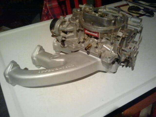

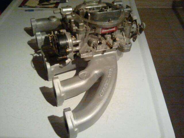

Not sure how soon I'm going to get to it but I'm slowly gathering all the goodies for it. My idea is for my 225 SSS (Sleeper Super Six)
Got my Offy intake....the Edelbrock is just for show....I'll have to use something smaller. My intent is to go four barrel but paint it just like a stock Super Six. I can apparently use something like a 360 air cleaner base from a Dodge truck that will fit a 4 barrel and the Super Six pie plate will fit. Bone stock appearing with a little something extra...... Nothing will happen till the spring at the earliest.....but in the meantime I can stare and dream.....

Without a major overhaul I think tops I can go something like 390 cfm so it's not over the top. And yes.....gas mileage would still be pretty good as long as I can keep my foot out of the secondaries.

What cam are you going to run? It would be a shame to run a 4 bbl and not take advantage of it with a peppier cam.
I haven't even gotten around to cam shopping or consulting yet but I know I will have to go more aggressive or as you say it would be a moot point to even bother. I have a good friend who builds some fine race engines and he will be my consultant on this. I simply do not have the knowledge in that department.
I'm hoping to get up to 500 cfm if possible and let him pick the appropriate cam. I don't want to go insane on this though. Cam and carb is what I'm hoping to keep it down to.

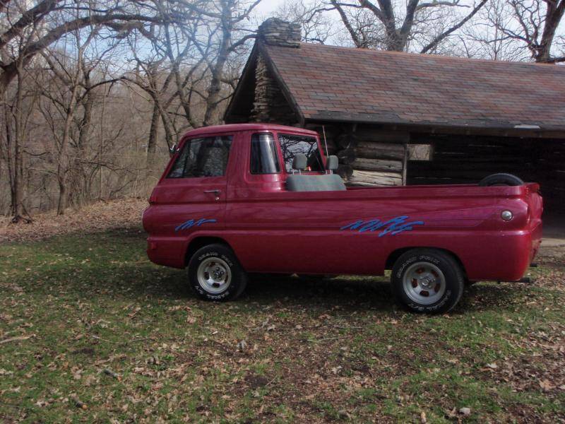

Just run a tractor stack straight up thru the hood like the diesel boys do!:eusa_whistle:. My A 100 has an Offenhouser, Holley 390, split header, 3 on the tree & I think 4:10 gears. Don't know about the cam but it's a blast to drive!
